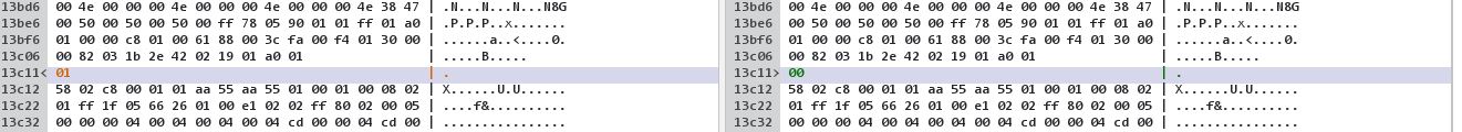

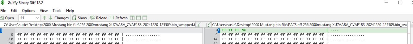

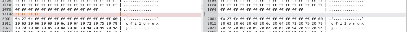

This thread is from last December. I did as you instructed the original thread starter and then was curious of what changes occurred. There were 4 changes. I assume that the changes have to do with everything from checksum to switching power onto injectors and maybe even something to do with the security indicator light? Just curious.

simply open it with tunerpro and do a compare
you have everything you need already
