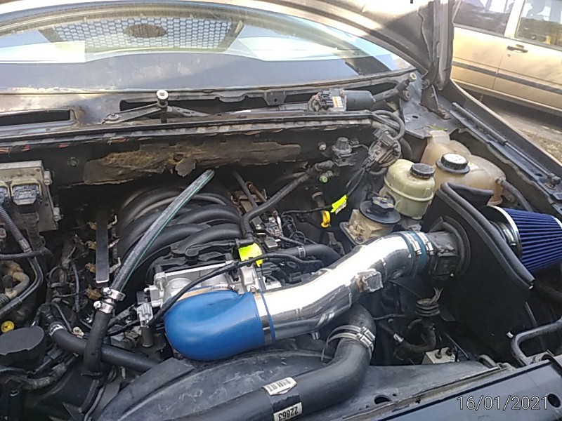

My current test bed is my old super reliable F150 4wd, 4.6-2v. Its been from coat to coast and on top of ever mountain range in the contiguous states over the last decade+. It's basically paid for everything else that I own.
Last year I purchased a brand new Ford racing 3v still in the crate. The previous owner purchased it thinking it would fit into his foxbody without mods. Long story short- I got a great deal on it.
My intensions are to get the motor running reliably and broken in wherin which I can use my years of accumulated autosports experience to become proficient at ecm tuning. After I've progresses with step 2, I intend to begin collecting and fabricating components to install a mild single turbo for install, then self tuning. Of course, in the mean time, I've got a few other vehicles that I am constantly maintaining and improving.
17MAR21- CURRENT STATUS:
Engine is in and running. I've had many failed attemps to flash any files to the ecm other than the stock file using a Kess V2. It read and identified files easily but would never write. After 90 to 100 hours of experimentation over 2 weeks(and despite having a degree in microcomputer systems mngmt) the Kess has proven useless for this particular vehicle.this stage of the misadventure included familiarizing myself with RT, Winols, ECM titanium, and a few other tuning software.

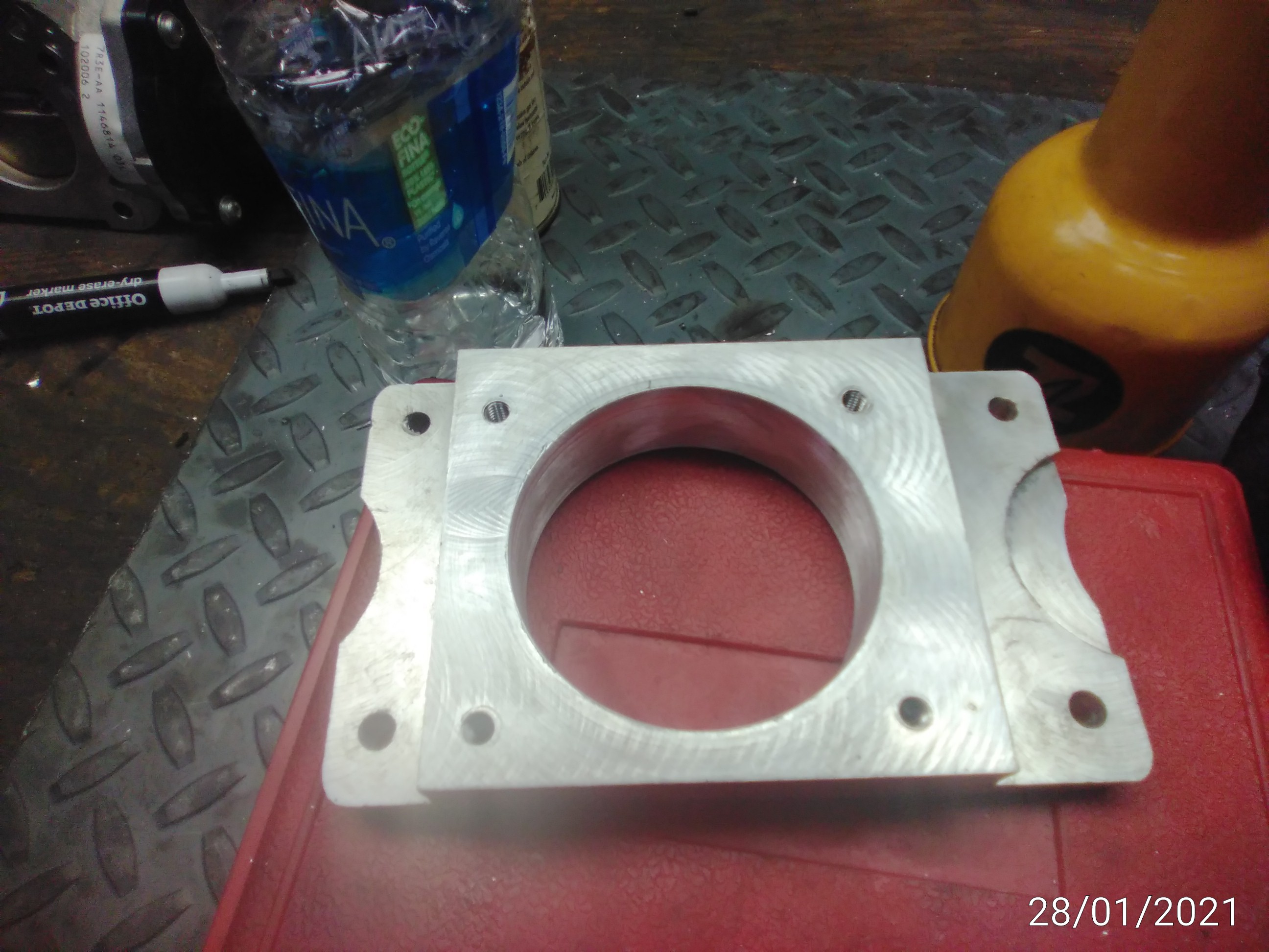

Lastest action included temporarily replacing FRPP 30# injectors with some ebay ~20lb injectors to prevent drowning and reinstalling the original single blade throttle body on a milled aluminum adapter plate that I concocted. Though far from what i would consider "driveable", I was able to deliver a stove 30 miles away. I don't want to know what the insides of my newish Kooks Cats look like...if there is any inside left.
Next Move: figure out which tuning hardware actually works with my rig, then plan my next move.
