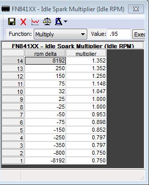

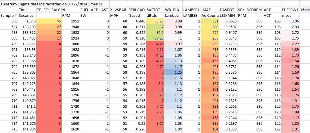

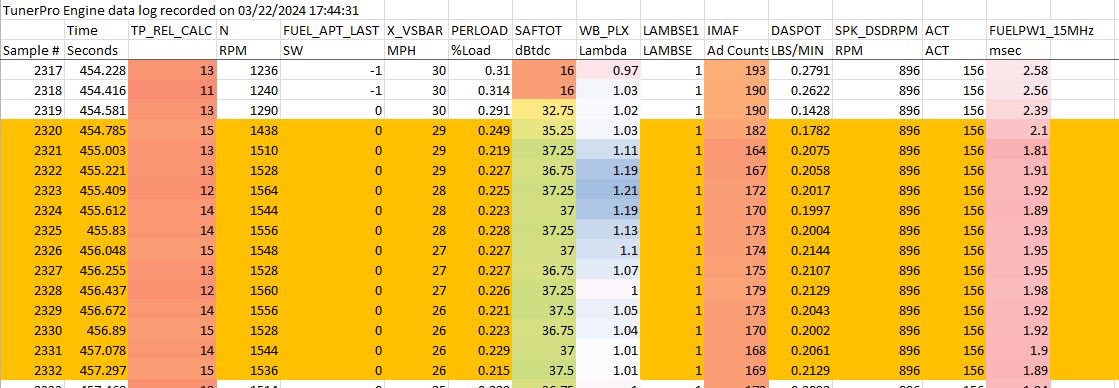

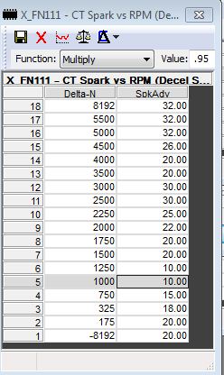

New problem, which seems to come with the delta-n modification(my old tune wasn't doing this). See the attachment(DFSO Spark Retard). When the throttle closes (Fuel_APT_last=-1), spark advance drops down to single digits. Looking at the tables added for Delta N it seems to be doing what they are set at. The question is....why? I'm getting exhaust backfires on decel, which I never had before. This table(FN111) seems weird to me. multiplied by these(FN841, FN839)? Also, and this is with both new and old tunes, when I'm cruising on the hairy edge of closed throttle(for me 60 mph, ~1750rpm), the motor goes lean and 'clunks'. This is happening when fuel_apt_last=0. It seems to be tied with the tp_rel_calc, when it drops between 10-15 counts. Below 10 it kicks into closed throttle, and it goes lean. Above 15, part throttle, back to normal. But when it drops below 15, above 10, it still seems to go lean. This is super annoying, as my drive to work is a 60mph 2 lane cruise. Any way to turn it off? Am I missing something simple here?

spark is supposed to drop on closed throttle at higher rpms thats the objective
thats not backfires thats decel burble, it means you dont have enough delta pressure. You can simply kick up spark on decel to reduce it but in doing so it will tske longer for rpms to fall and youll have less torque reserve
nope, fueling has nothing to do with throttle position. Sounds like you need to dial in your fuel injectors.
