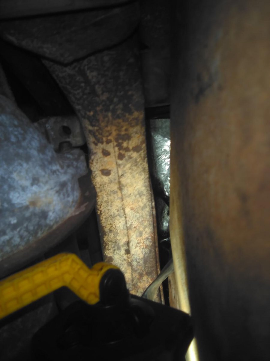

I took care of the transmission ear today. I ended up cutting off half or more of it.
Square nub in the dark left side of pic touching manifold.
Now the manifold sits up tight. The M II rh manifold is the only
Ford manifold that will fit in this tight space. Old 1965 Mustang HiPo manifolds may fit too.

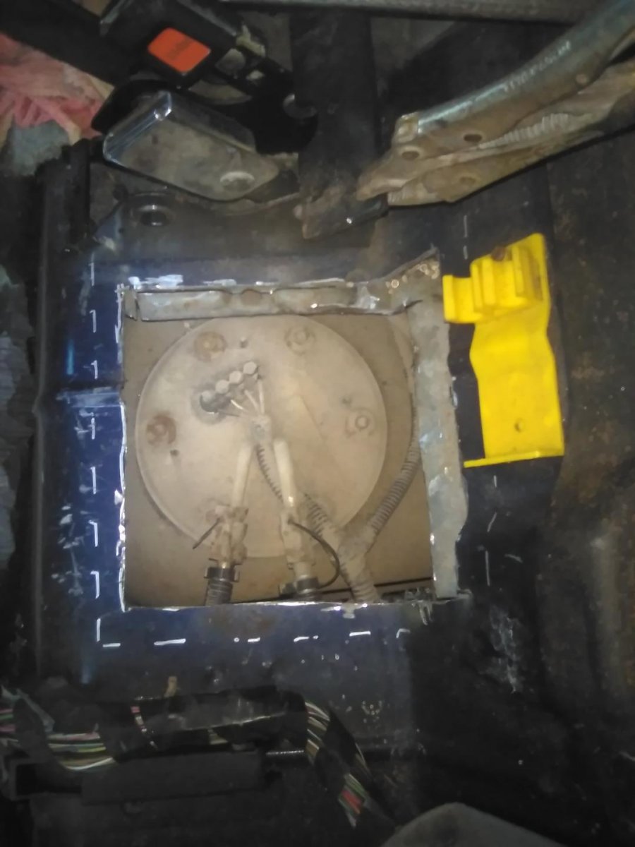

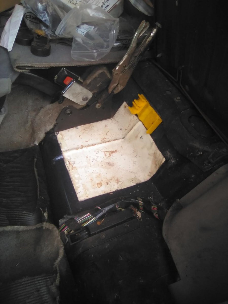

ADDED:12-08-24 Fuel pump access hole cut. I decided not to drop the entire fuel tank. This is a common 1995 to 2001 (generation 2) Explorer/Mountaineer modification.
Access panel cut and fitted.

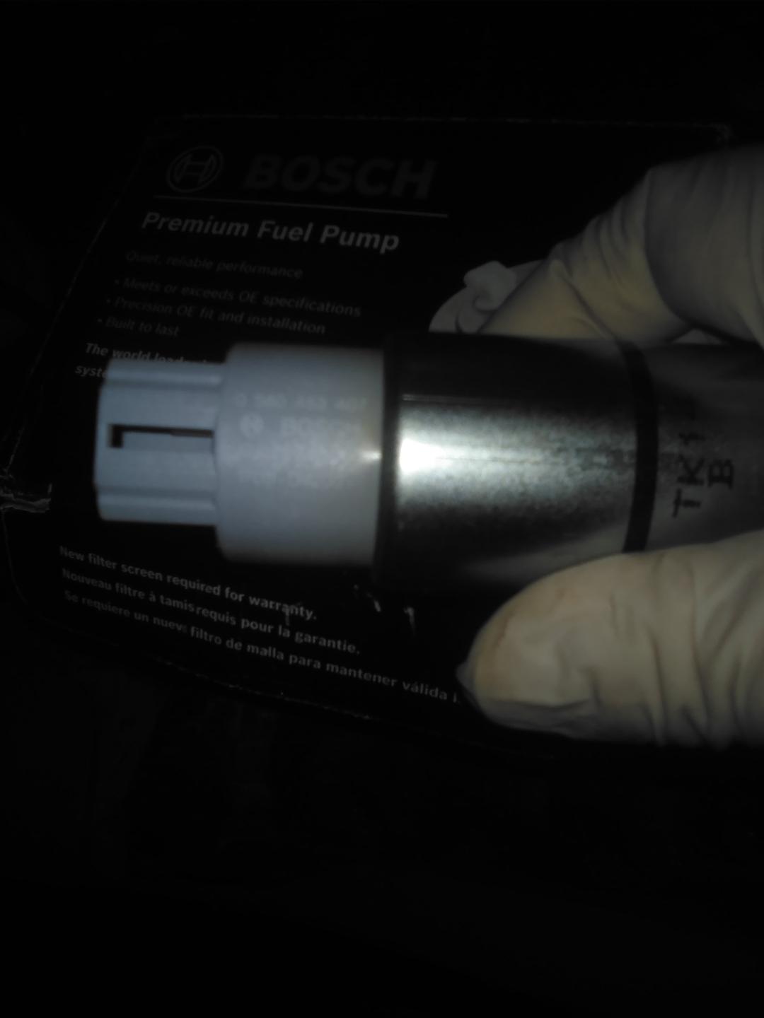

I was collecting up info etc., in the second post dated 10-02-24, while working out two significant issues. A leaky Bosch injector and a significant exhaust leak. I go tomorrow morning to pick up rh exhaust manifold that had to be surfaced and then go by an exhaust shop to make a 12" long down pipe. Last Saturday, a new Bosch fuel pump cartridge was installed. Fuel pressure reaching 40.5 and bleeding off. Confirmed with a Marshall fp rail gauge and a MATCO fuel pressure tester. #7 spark plug looks washed. Very recently purchased reman Bosch set. I will know more after flushing injector both directions. Maybe a little piece of EDPM from making the braided fuel lines. I won't know until after cleaning.

I've recently installed a 2nd fuel pump. Just a cartridge this time.

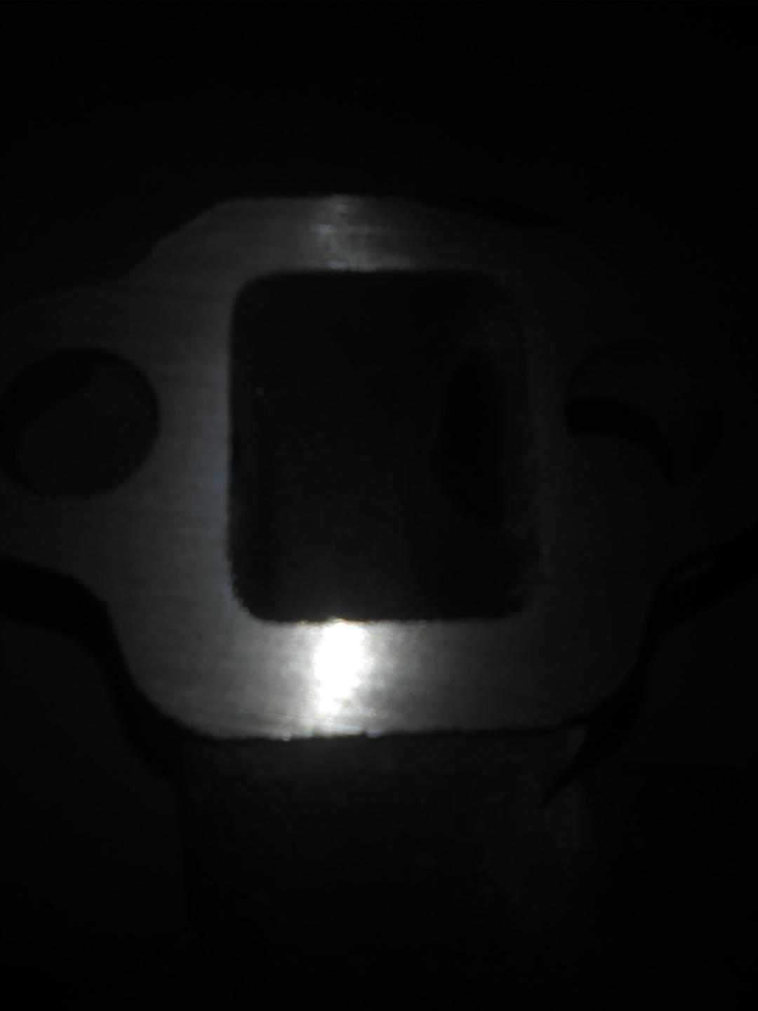

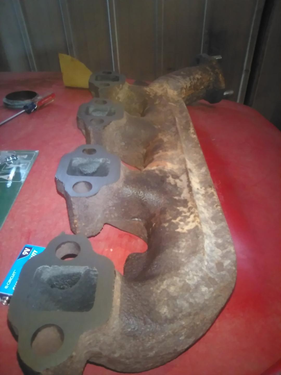

I had two exhaust leaks to deal with. The first, a warped antique 1975 Mustang II V-8 passenger side manifold. I had it surfaced.
