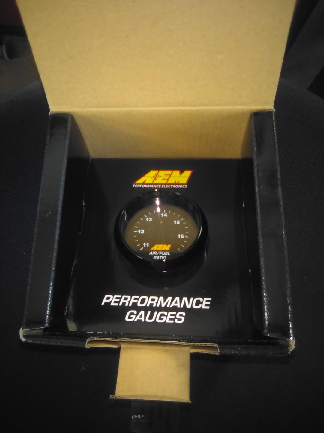

The wideband AFR gauge/O2 sensor kit should be here Monday or Tuesday. After trying to start it but no fire, the injector noid light wouldn't light. I changed to another camshaft position sensor, the noid light worked as well as the inline spark indicator light. After building fuel pressure, the engine fired. So far it has idled only for about 30 seconds twice. The tach is not working as well as the start circuit has an open short or the digital range transmission switch is not calibrated. The rh exhaust manifold donut gasket is the wrong size and leaking. Transmission engaged. Just a few more things to wrap up before a test drive including installing the AFR gauge. I wouldn't be surprised if it is running a little lean after being warmed up. It is a 4.6 tune running a 5.0. But maybe the PCM will adjust to its feedback and run about right. We will see.

ADDED Oct 1st: Monday the AFR gauge kit showed up. It will be installed today. Also, most of the hands-on time was spent disconnecting the rh manifold to flange connection and reconnecting it. The working space for this is very tight in the Ex/MM bodies. I assume it is the same as it has to do with the small Rangers. I got another set of eyes to look at the area of the leak. I couldn't see it but all across the bottom of the rh 1977 Mustang II rh side exhaust manifold is not sitting down against the exhaust ports properly. I'm sure that those of you that have been around 4R70Ws have seen the big square block nubs on the side of the transmission case. The nub is holding the manifold from sitting against the cylinder head properly. Hopefully the Sawsall will fit up in the tight space to chop it off. The working space is very tight and right next to the dipstick tube for the transmission.

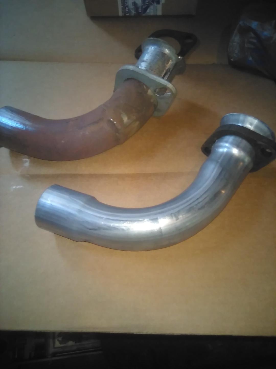

I've recently installed a 2nd fuel pump. Just a cartridge this time. I had two exhaust leaks to deal with. The first, a warped antique 1975 Mustang II V-8 passenger side manifold. I had it surfaced. The 2nd leak was from me trying to adapt 2.25-inch exhaust to a 2-inch manifold. I had a new piece of two-inch downpipe made. Soon I will get this part back together. I also have a #7 fuel injector sticking open. I'll be required to strip the upper plenum and related parts to get down to the fuel rail and injectors.
