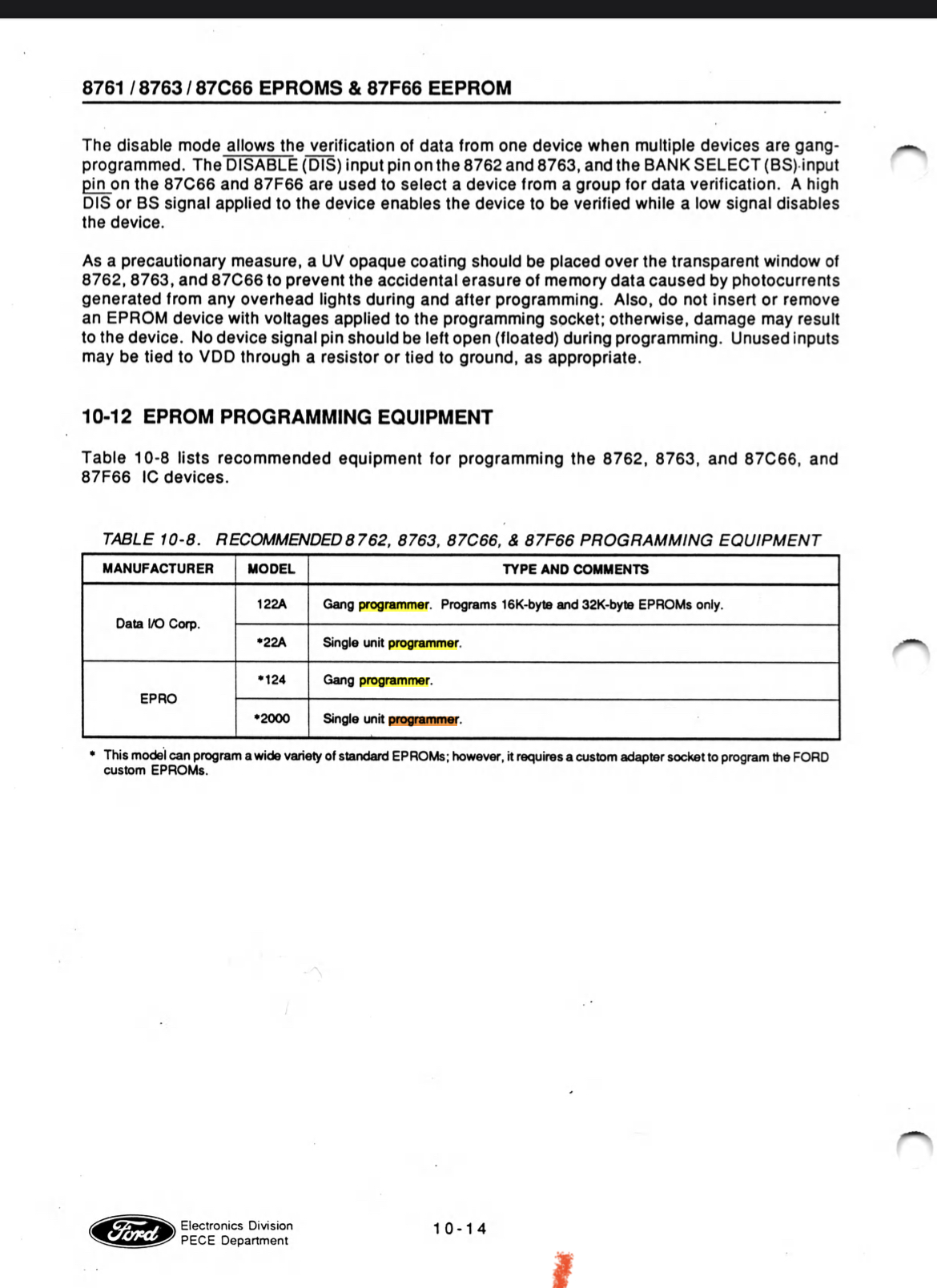

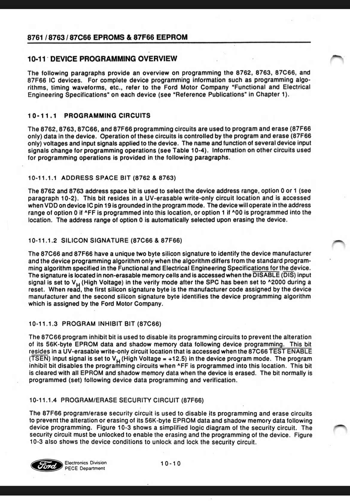

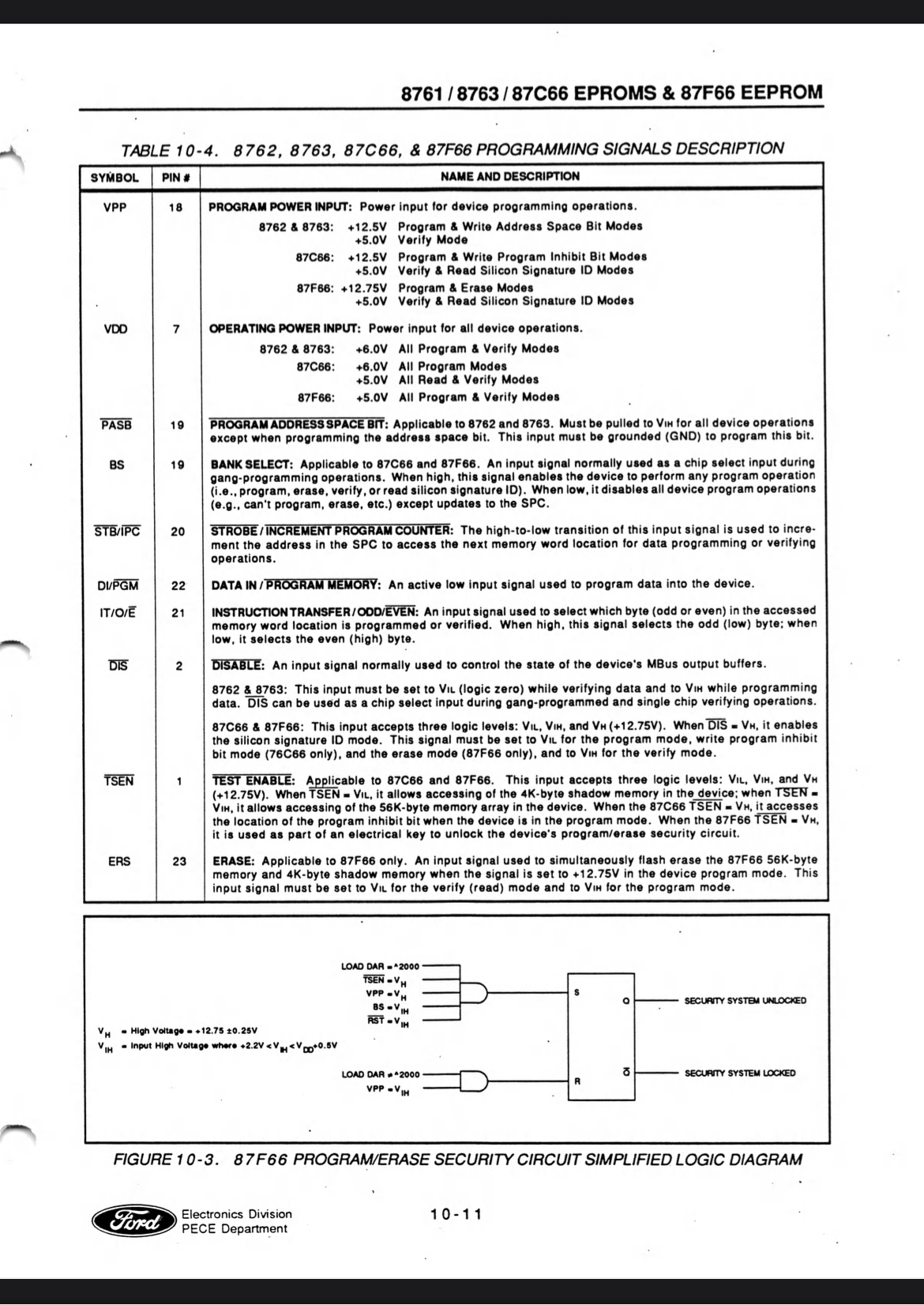

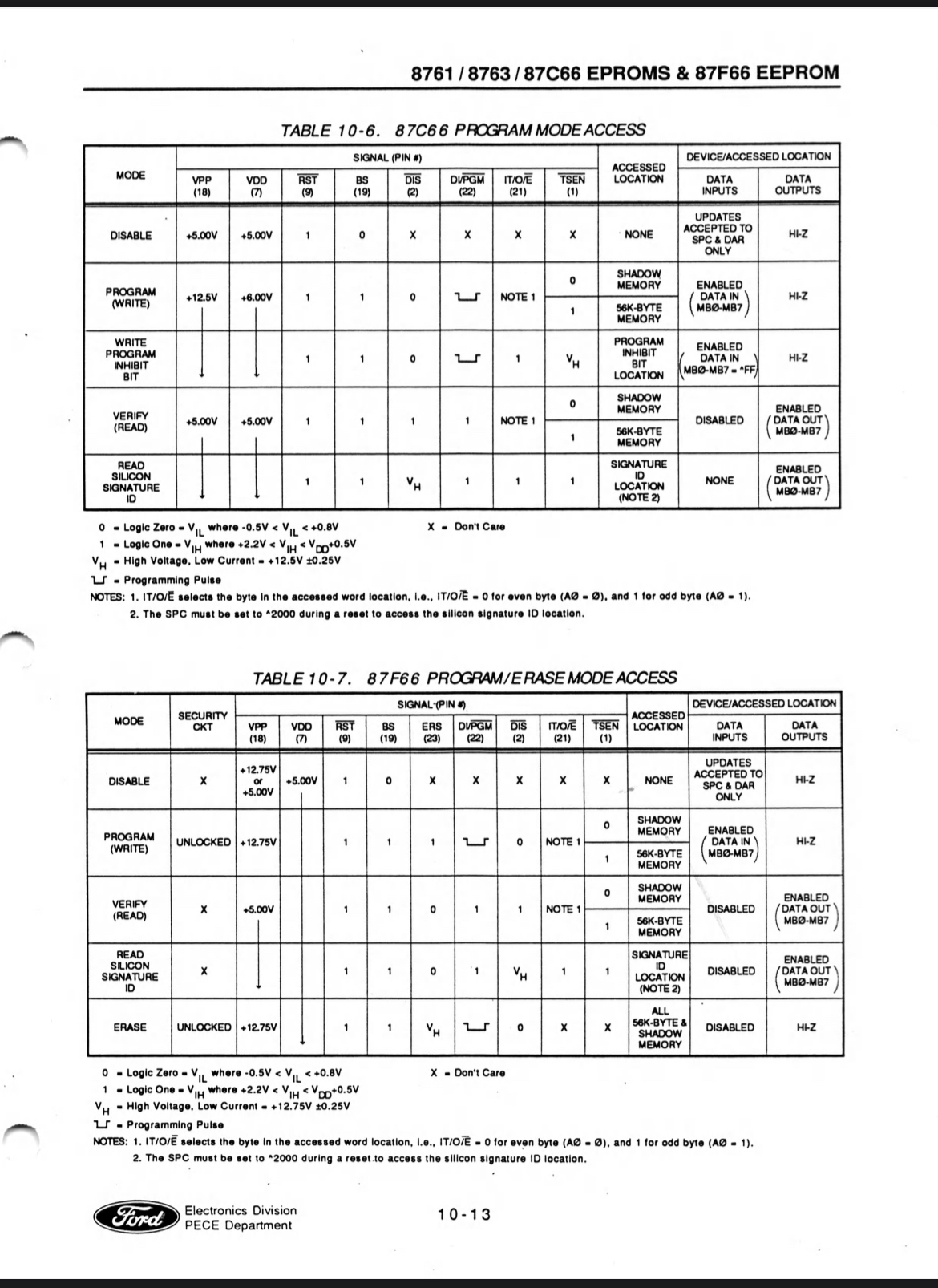

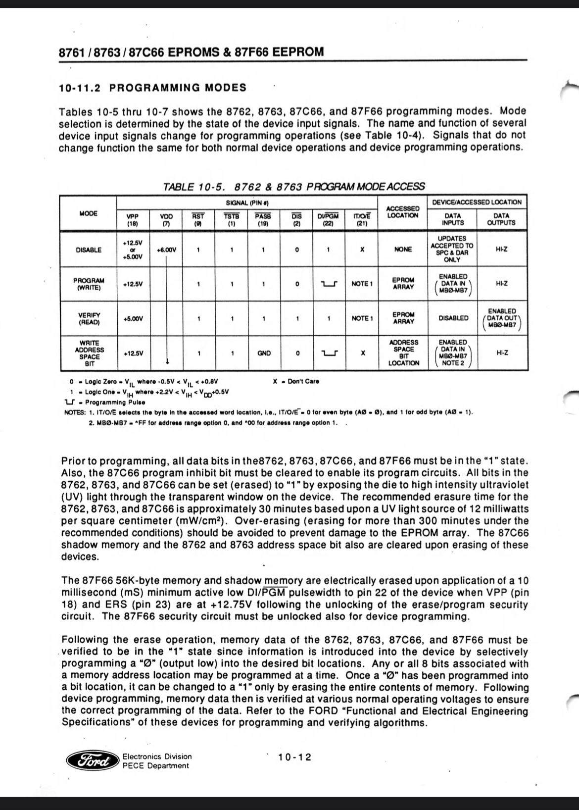

I stumbled across this recently. I'm sure some of you have seen it as it's flaoting around. has some info on eprom programming.wwhite wrote: ↑2022 Dec 08, 21:18That's how we did it in the early 90s.efloth wrote: ↑2022 Dec 08, 07:17 It would be cool to do a uv erase like this: https://youtu.be/_sSuzDg4ntA
I follow that youtuber, The software he uses looks like the programmer has configurable pins. That is what would be needed to program a stock Ford EEPROM. The programming/write pin that takes 12-15V is on the middle of the chip, pin 18 or something. Most EEPROMS its on the beginning or end of chip pins, like 0/1 or 23/24 or 27/28, something like that.
Anyways, UV erasing the EPROM should result in a read of all 0xFF's, chip bits all 1. When it is written it writes 0s.
It's all about testing and succeeding!
https://drive.google.com/file/d/1ypPYhu ... p=drivesdk
