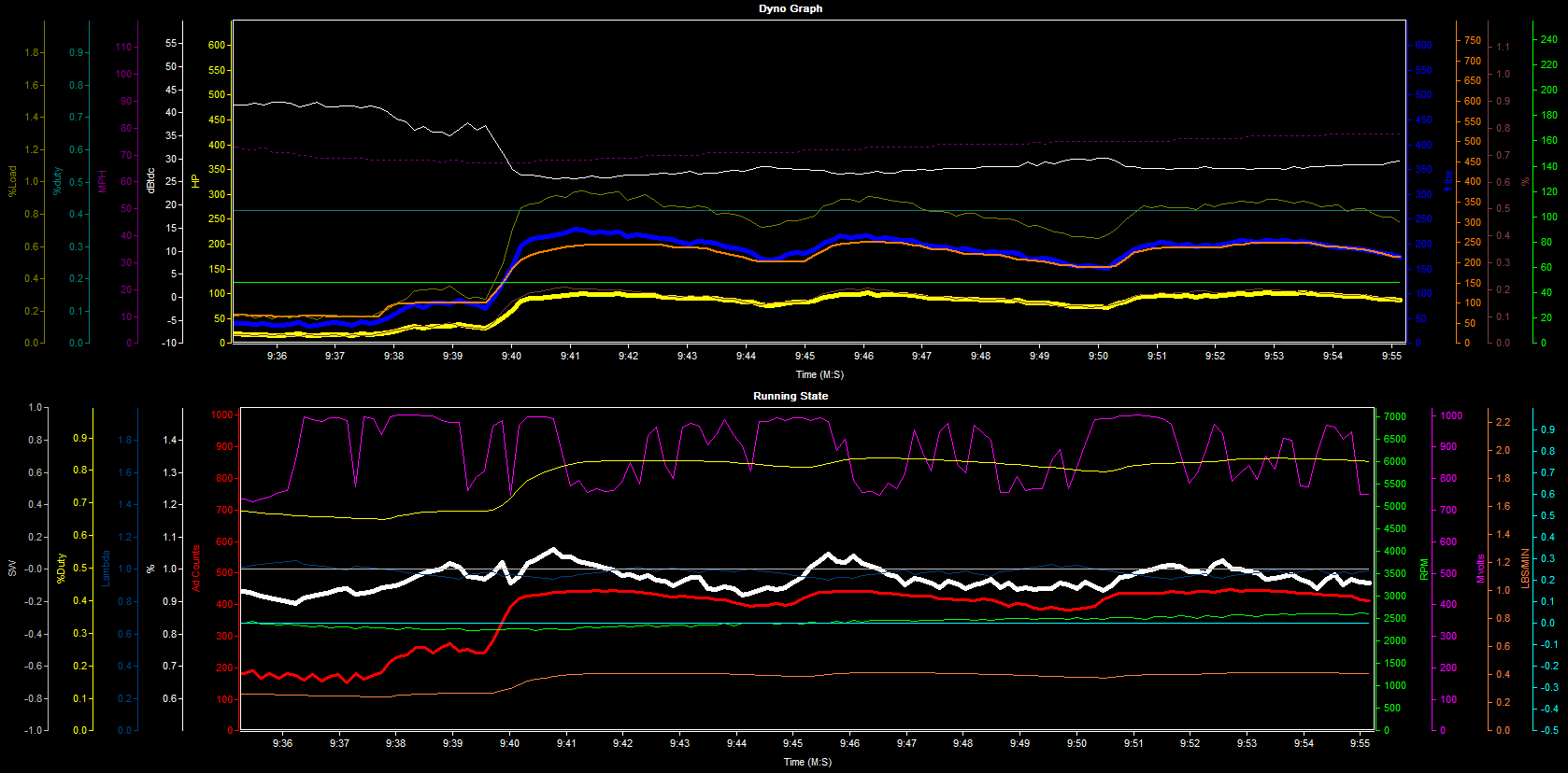

I finally have a working transmission again and holy shit is this one fast :D 0-60 in 9 seconds and she's got tuning room to grow :D <3 I also do rolling starts vs. hard starts cuz I respect my gears and gain nothing from trashing them so it's probably a second or so faster :D I built the trans myself which makes this more awesome ;) AOD w/ 4R70W gears :D <3 I can now modify it and know what I'm doin and have reasonable expectations of results. My friend put it best when he explained it to some others "He got so pissed about his transmission and getting ripped off he learned how to build it himself" and that is 100% factual ;)

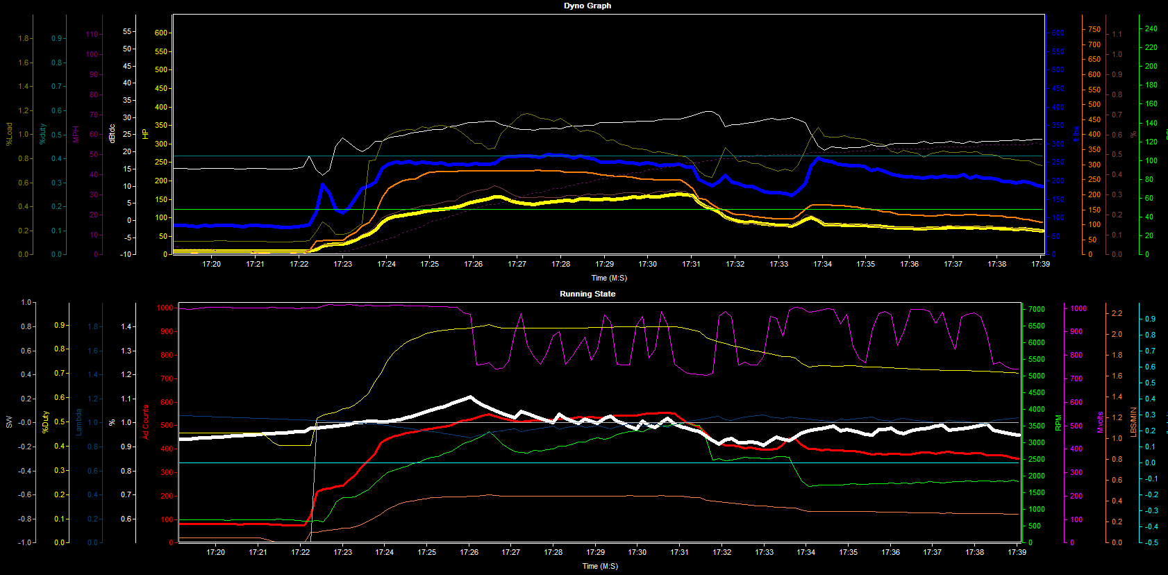

So here's some log screen shots of the difference between the AOD I smoked (F' Monster Transmissions for selling me a stock AOD w/ original Ford OD for the HP/HD 3x price) vs. the new AOD w/ the 4R70W gears I heavily built.

Just before blowing up the AOD w/ a pretty solid tune: Blowing up the AOD because everything was working so wonderfully and some guy had to show off with an accel on the freeway so I had to show him up..... Smooth Operator :D At least the OD band didn't fail until I got off the freeway so he never saw any issues :D 2 Results after the AOD w/ 4R70W gears build I did and my first MAF table adjustment after I'll have a few more to do after to fine tune it again but now w/ the consistency w/ everything, it really should tune well. It may be a "no brainer" that a perfectly working drive train will give more consistent results to tune around but it's very different from the "awareness" vs. knowing since we have real data to see/prove things vs. "the feelz". It's def the nice thing about the entire journey I've had so far (more to go) goin from what felt great to... Holy shit! And STILL having more to go but more importantly everything in between so I really do have a good understanding of good vs. bad and so much more vs. just "the feelz" :)

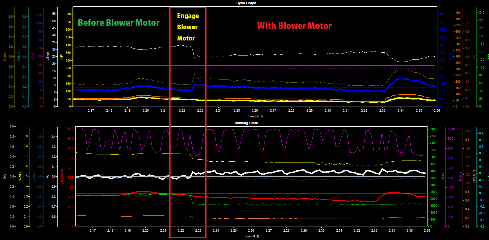

So I have an interesting story to share about an 87 Ford Truck. Ford put the HEGO wiring on the blower motor circuit. Because of how they wired it, the blower motor while off allows the Negative current into the Positive current..... When the blower motor is on, it causes about a .1-.2 voltage drop for the HEGOs on the 1 and 2 settings. The drop increases the higher the blower setting. This as you'd imagine really messes up the EFI because the O2s read lean so the ECM adds more fuel... O2s continue to read a lower value and you can imagine how this continues. I've never used my heater for over a decade cuz of the voltage drop. Now I have all these fancy logs I got to see it was only on one circuit, the ECM is not affected. Well... I thought so but then watchin the logs while tuning, I turned the heater on and watched the HEGOs drop.... BS!!! But ok. I've removed the blower motor off that circuit and things behave better now especially the HEGO readings. I can also use my blower motor again albeit there is still a hit to the HEGO.
Putting the blower motor on it's own Negative circuit and retain the switch/speed functions is gonna be a nightmare which requires ripping the entire dash out. So that will never happen. The impact isn't too horrible so as long as I get my tune solid, then I can live with the performance impact it will cause.
The key thing is I had to move the Positive for the blower fed directly from the battery via a fuse/relay. W/ the relay, that feedback loop can not occur ever unless I turn the blower motor on vs. w/o the relay/dedicated Positive, that feedback loop is always there. The most F'd up part is testing the current on the Positive & Negative wires for the blower motor. Key off, they register as Negative to the battery post current test. Key on... They both register as Positive. Blower Switch on, they register correctly at the motor but at the resistor pack, Positive AND Negative are present on the Negative wires and Positive wires hence why it messes up the HEGO readings.
Below is the thread I made regarding this and I'll write up another thread about the fix I did. Still this is a big cause for the fight I've had w/ tuning my MAF curve... Add all the other issues I had to and it's been a hell of a fight ;) In this case, this is literally "by design" from Ford. They fixed the issue somewhere between 87, 88, or 89 before they finished the 4th gen line of trucks too. Such a horrible gen only cuz of all the weird shyte Ford did to em.

Here's the log of when I turned the heater on and the pic of the graph showing when it happens. I only set it to #2 for the speed setting too so 3 or 4 would have a much larger impact. Turning on the AC has an even bigger impact but I've never recorded that since I don't use my AC/not charged. It is all functional/new, just don't care w/ the open top and really wanted to finish the engine before I charge it in case I have to pull anything off. Regardless, when I did have AC many years ago, turning it on would bog the engine down heavily. Thought it was just normal but now seein this since now I have logs, (knowin how to read wiring diagrams better helps too) I see what likely happened and why the truck runs like shyte w/ the AC. Might not be an issue w/ my fix tho. TBD one day maybe ;)
