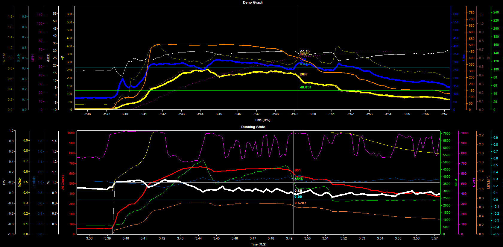

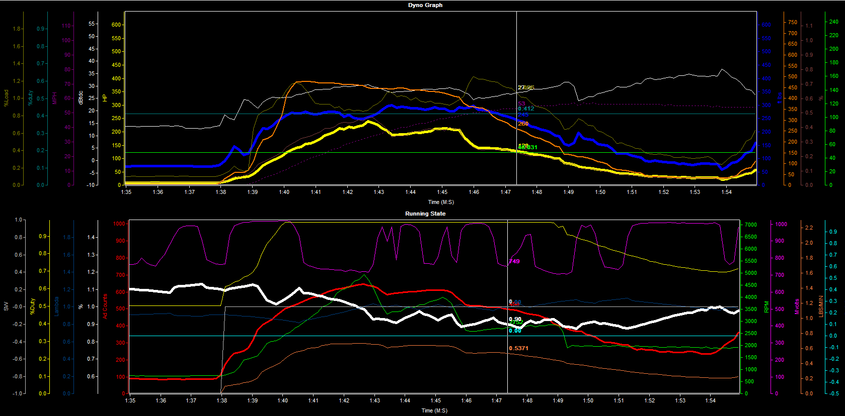

I finally have a working transmission again and holy shit is this one fast :D 0-60 in 9 seconds and she's got tuning room to grow :D <3 I also do rolling starts vs. hard starts cuz I respect my gears and gain nothing from trashing them so it's probably a second or so faster :D I built the trans myself which makes this more awesome ;) AOD w/ 4R70W gears :D <3 I can now modify it and know what I'm doin and have reasonable expectations of results. My friend put it best when he explained it to some others "He got so pissed about his transmission and getting ripped off he learned how to build it himself" and that is 100% factual ;)

So here's some log screen shots of the difference between the AOD I smoked (F' Monster Transmissions for selling me a stock AOD w/ original Ford OD for the HP/HD 3x price) vs. the new AOD w/ the 4R70W gears I heavily built.
You can see my full tear down review of the AOD Monster Transmission sold me... It's pretty horrific...
https://www.fullsizebronco.com/threads/ ... rs.527152/
Just before blowing up the AOD w/ a pretty solid tune:
Blowing up the AOD because everything was working so wonderfully and some guy had to show off with an accel on the freeway so I had to show him up..... Smooth Operator :D At least the OD band didn't fail until I got off the freeway so he never saw any issues :D
2 Results after the AOD w/ 4R70W gears build I did and my first MAF table adjustment after I'll have a few more to do after to fine tune it again but now w/ the consistency w/ everything, it really should tune well. It may be a "no brainer" that a perfectly working drive train will give more consistent results to tune around but it's very different from the "awareness" vs. knowing since we have real data to see/prove things vs. "the feelz". It's def the nice thing about the entire journey I've had so far (more to go) goin from what felt great to... Holy shit! And STILL having more to go but more importantly everything in between so I really do have a good understanding of good vs. bad and so much more vs. just "the feelz" :)
I will say the best part right now is the reactions of folks when I disappear from a light. There's been several times now that everyone just sat at the light even tho it was green :D <3
Thank You again, again, again Decipha for your part in these capabilities <3
