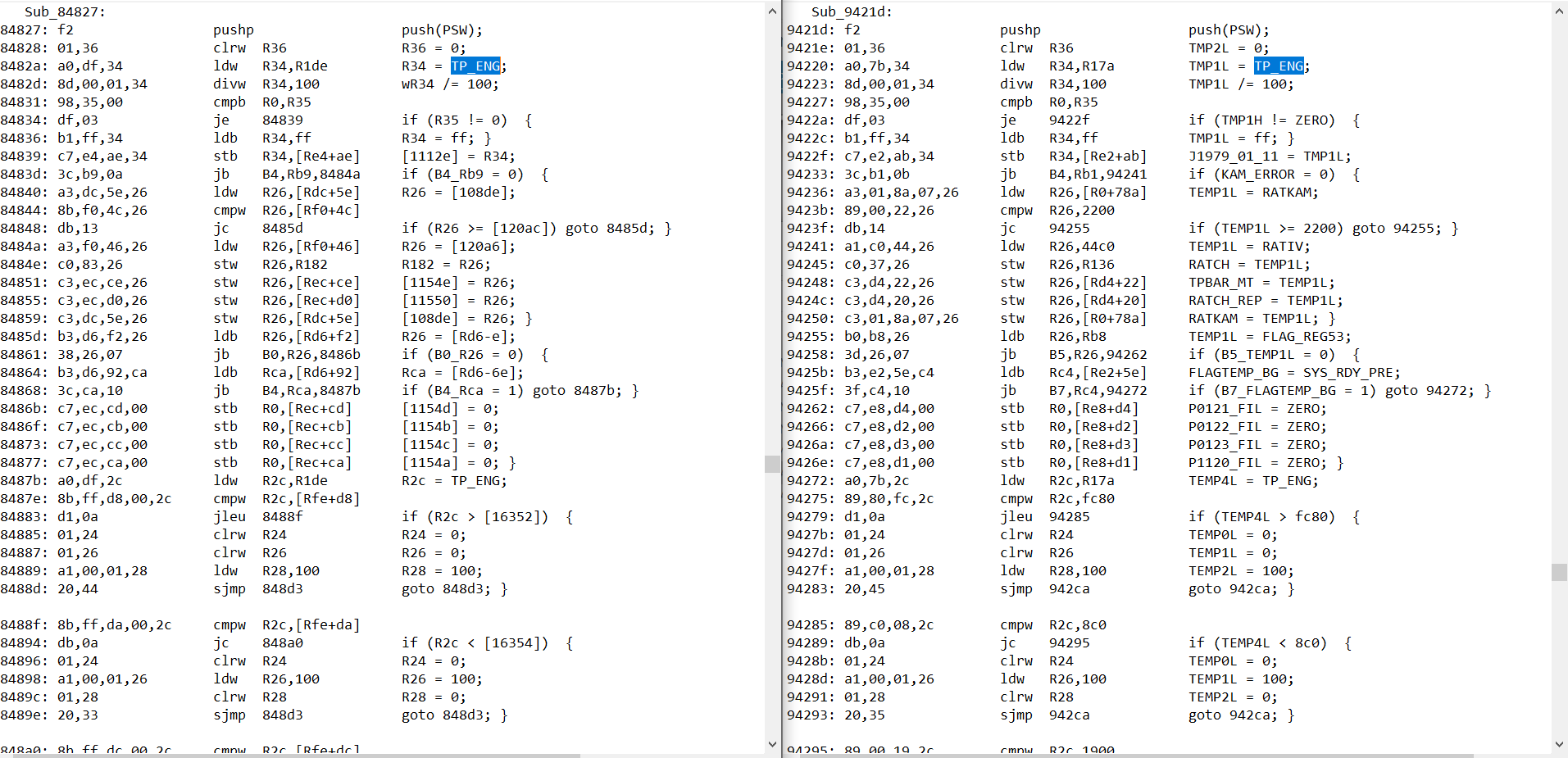

Ok. Just thought I saw something and wanted to confirm. I’ll stick to the tp_eng. Lol. Should there be more occurrences of the tp_eng that I am looking for or just pointers to other functions from tp_eng? Sorry if that’s a silly question. Also, should I be focused on the lst files or the msg files or both?

Found this one. I'm still working out exactly what it is doing, I'll edit this post later if I can figure it out, lol.
Also, where can I find a calculator to figure out that this-[Rec+c8] is [11548]? I have downloaded a couple of hex calculators from the apple app store but cant seem to find one that works well for me. Thanks so much for your help, again.

BOOSTEDEVERYTHING wrote: 2023 Oct 26, 08:10 Should there be more occurrences of the tp_eng that I am looking for or just pointers to other functions from tp_eng?
Consider it unknown, so search for more occurences to prove either way.
LST and the 2 strategy docs I previously mentioned.
Post up the page number from each strategy for the tp_cnt>tp_eng sub.
BOOSTEDEVERYTHING wrote: 2023 Oct 26, 10:31 Found this one. I'm still working out exactly what it is doing, I'll edit this post later if I can figure it out, lol.
Good find.
Post up the DIR and CMT entries for it.
The default windows calculator can be set to programming mode to do it.
