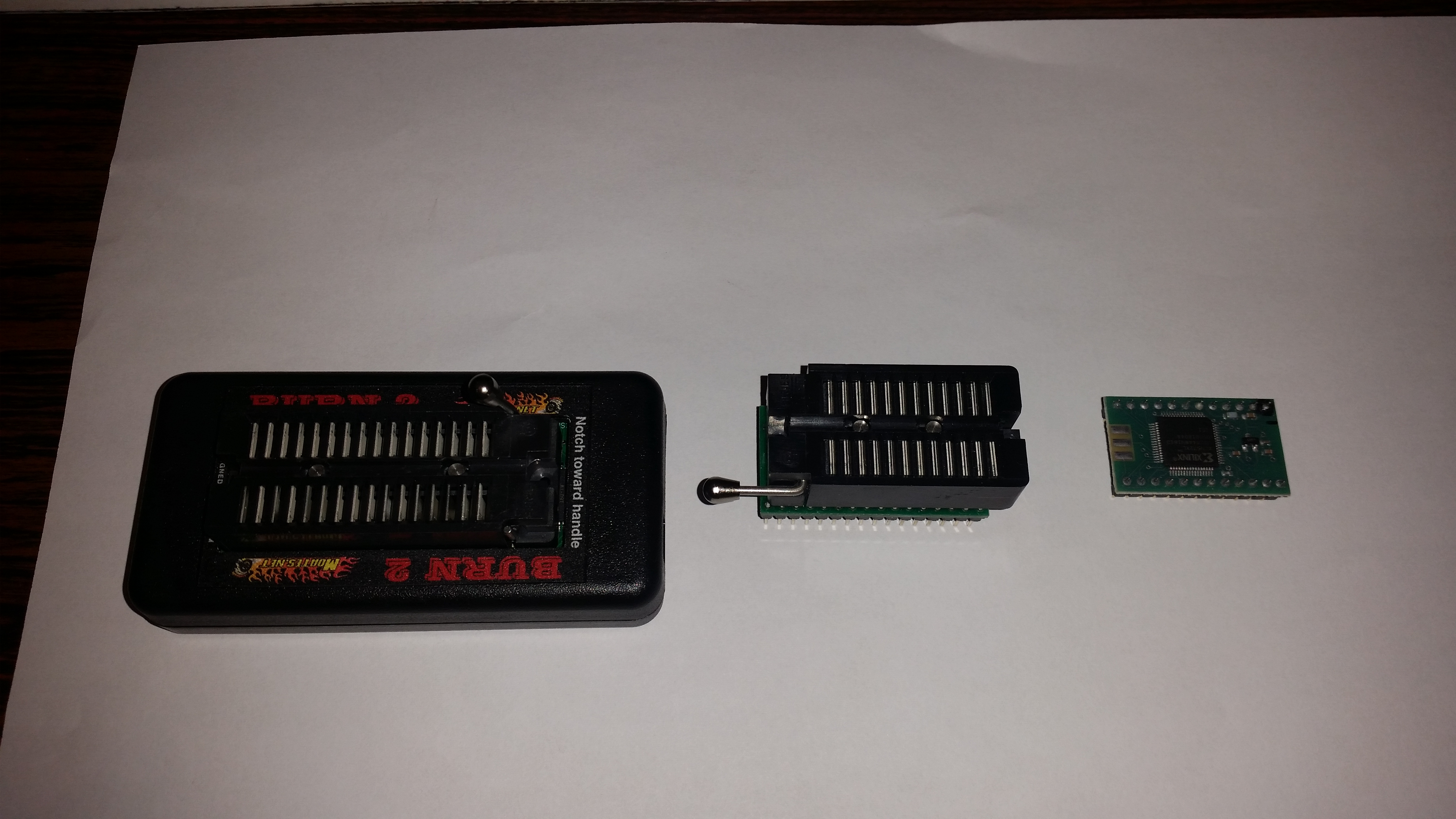

Sorry mate I won't part with them. I bought enough to cover myself, my brother and a mate, with a couple of spare.Would you part with one? Do you know if the Burn2 just had a special pigtail to connect it or if there was something more custom done to it?
The Brn2 has custom firmware (FIRMWARE 5.70 CARDONATOR).
It has an adaptor that goes between the Burn2 and the chip.
I will post some photos later on.

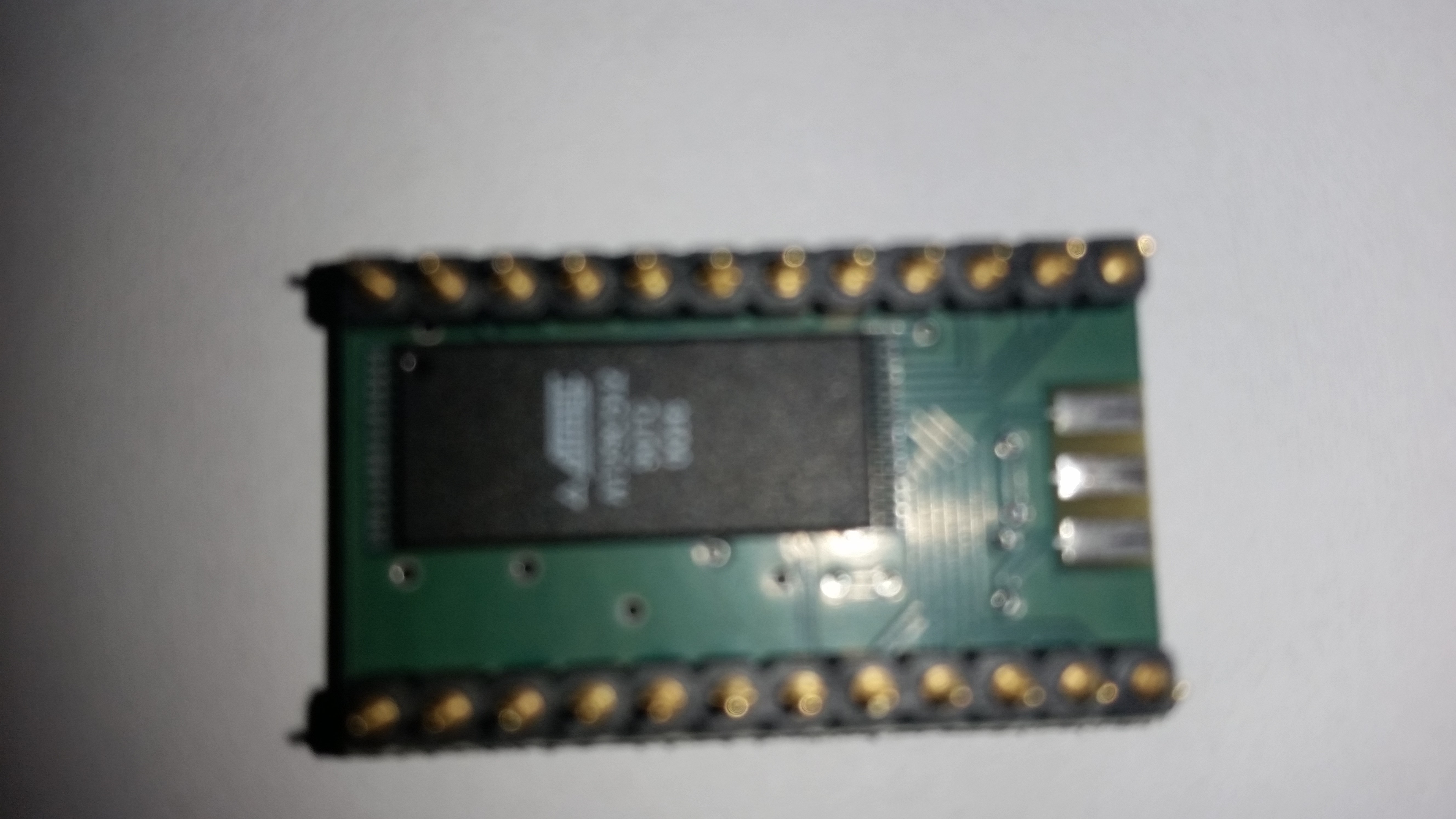

That is what I was thinking just not with a surface mount device!xd4.1efisc wrote: ↑2022 Nov 30, 05:51 Top photo was a Moates product not available to the public. I managed to purchase 8 of them last year. A custom Burn2 was also required to program them.
Would you be able to send a pic of the memory device? I assume it is not publicly available as sailorbob states but it would be a good starting point.

Attached are the photos of the Moates Boards.
Sorry about the shit picture quality but my phone won't focus properly for some reason.
They are pretty much f3's that solder in place of the factory EPROM.
Moates also told me they can only be used on EEC-IV.
I think Moates supplied them to an ECU remanufacturer.
I never liked the way things hung out of the J3 port as a permanent setup, and last year had a customer/mate who I converted his F150 to A9L, and he did not like the possibility of the f3 working its way off the J3 port when 4wding, so I contacted Moates about getting some.

I have to say Moates have always been very helpful over the years, going back to 2008 when I was using an Ostrich, the first one I bought was faulty they replaced it no questions asked.. They are priced the same as F3v2 chips ($75) so you can order F3v2 chips and put a note in the 'Comments' that you want the special EECIV only internal chips. They do NOT work for 96+ applications.
To program them, there is a custom adapter required. $10. You can order a HDR1 (same price) and put a note that in the 'Comments' that you are after the custom EECIV Chip adapter, not the HDR1.
To program them, a BURN2 with custom firmware is required - $85. If you use your BURN1 for programming other chips, it would be a good idea to have a second programmer because the unique firmware required won't program "normal" chips.
