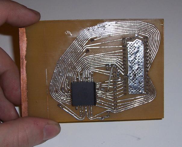

I found a picture of a custom Eprom in an A9L I tried to figure out who it came from but couldn't find anyone that claimed it. The picture was on a ECU rebuilders website in an area talking about capacitor replacement. Obviously this is nothing as cool as a Quarterhorse clone, no data logging and such, but looks like an Eprom emulator. I imagine this was created to clone the A9L by installing it into other GUFX EECs. I'm guessing the 3 contacts on the edge is the interface used to load the BIN into it. I found another very crude looking creation also picuters atached.

Top photo was a Moates product not available to the public. I managed to purchase 8 of them last year. A custom Burn2 was also required to program them.
