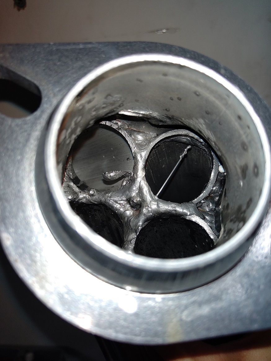

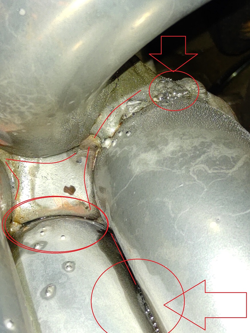

Decipha will prob appreciate this... You were right! :) I did have an exhaust leak.
It never occurred to me that I'd have to check the welds of the pipes at the collector of the brand new HTC coated Hedman headers, Part# 86476. The passenger side has a really bad leak in a couple spots from some truly terrible welds. I'll spare the BS story between but I have a new set of the same exact Hedman headers made at the same time/place the last ones were since they have production dates laser etched and this part# only comes from the CA facility. They have the exact same terrible welds, and it leaks the same. The new set even came with a pre-installed NC whistler in one of the pipes :D :\ I have a 3rd replacement set that'll be here eventually so we'll see if it's 3 for 3 fails or just 2 out of 3....
I attached pix for your viewing horror of the leaking welds but there's spatter and rust all over too. You can tell the weld prep work was non-existent here. Both sets made in 2022. The "used" set has about 6-800 miles and the new shiny set hasn't been used ever.

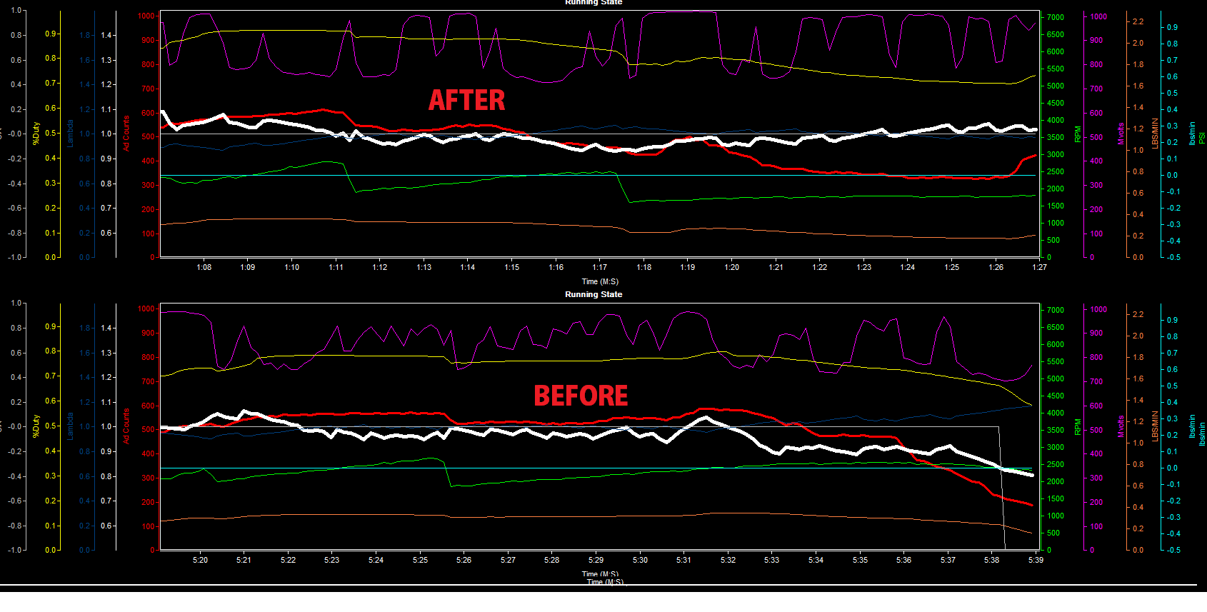

Another issue resolved and this was done with Rubycon brand Capacitors and the EFI Tuning is how I discovered the issue :) TL;DR, I replaced the capacitors in the ECM with the Rubycons and wow talk about unlocking an achievement!
So since I got the JBA headers I now TRULY have no exhaust leaks ;) Thank You again Decipha for calling that out and apologies I was cocky and falsely confident thinkin I had that all squared off. The tuning was getting better but the engine had what felt like some kinda wall it was pushin against. My truck has always had great acceleration but that "wall" always seemed like it was there. I just figured it was normal.
So the exhaust fix definitely unlocked a lot of potential in the tuning and now I really understand how critical an exhaust leak is to EFI especially when your injectors are over double stock, so you have less wiggle room for failure. I'm guessin that's why 19 lbs injectors are stock and the 24lbs is in the high performance Cobra package?

So previously my PW was about 800~ at idle. Now my PW is about 1800~ at idle. What's more important is the wave of the PW smoothed out especially under acceleration and you can really feel it. While the acceleration before was "smooth", it wasn't but it went no doubt. It's nothin like my motorcycle or super fast stock Subaru.
Looking at the graphs from then vs. now, I can say all the previously stumbly bits in the wave on accel were felt and now the smoothness of the wave is felt just as well. Pic attached of a hard accel and I JUST fixed this so I have more to go but here's a before and after of about 75% throttle accel with each tune bein I'd say 80% complete on the MAF.

So the capacitor fix really did waken things up, it wasn't Kruger's effect ;) PWs are still the same as reported and everything is just more snappy/smooth vs. chuggy. I think the pic I shared gives a good example of "a picture is worth 1,000 words". That pic of the PWs really explains stumbly, hesitancy, chuggy etc. for the Before and the feeling of Smooth, responsive, consistent really shows in the After part of the pic.
After the various tuning approaches I've taken I decided to stick w/ the STFT only. Every time I used just the STFT, things get dialed in fast. Then I'd move to the mix of LTFT, STFT, Fuel Error in various approaches and every time it'd be a downward slope where my performance would regress. I figured that'd polish everything off and maybe it could but so far tuning w/ strictly STFT has not failed me and has only given positive results/performance increase and/or stability/smooth transitions from cell to cell across the MAF table.

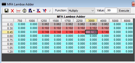

Also here's how I adjusted the MFA Lambse adder. From my reading this looks safe and proper for the higher load to have a leaner condition than the lower load. I saw Decipha sayin you can get to 18-20% lean so I didn't go that extreme yet till I get more time/comfort with how this all works out.
I have no idea what a knock feels/sounds like and the video I watched didn't help since it sounds like a quiet tick like an exhaust leak which I could never heard while driving.... :\ If someone wants to school me on how to identify a knock, I'll take the advice ;)
