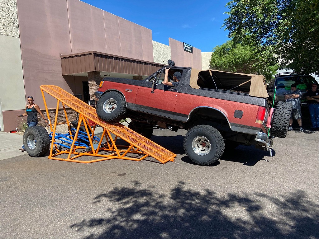

I've avoided sharin pix cuz this is a technical site, not a show off my toyz place but I figure this gives some clout to me not fibbin about puttin in effort and I can take them off if Decipha doesn't approve.

Nice!!! I had an 85 f150 which i won the who can go the slowest in 1st gear and 4Low. It had the np435 with about a 6 to 1 first gear. That truck had a small lift kit and 33 inch dunlop mud terrain tires and nice 302 with headers and 4 barrel.

Bad ass that's def a Lo Lo! The 302 is very impressive IMO and it's proven itself. That's why I went w/ the Ford Racing BOSS 347 stroker cuz the 302 HO was plenty but might as well add a lil extra but keep most of my stuff since I had to buy a new block; engine cancer. I have noticed I can almost watch my fuel gauge goin down now tho w/ the 347 block/42Lbs Injs :\
My other Bronco has a 4BT Cummins and an Atlas 4 w/ the 4Lo Lo so I can get out and walk faster than it can crawl too but she can climb hills all on her own :D Haven't done a slow drag comp with her but I won on my carb'd Honda CBR 600 :D

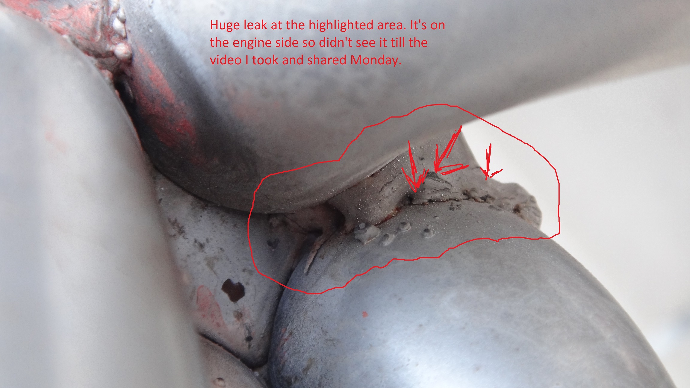

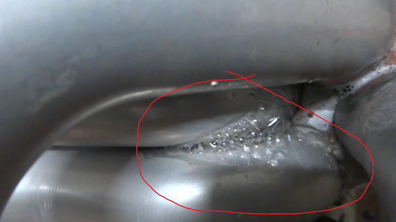

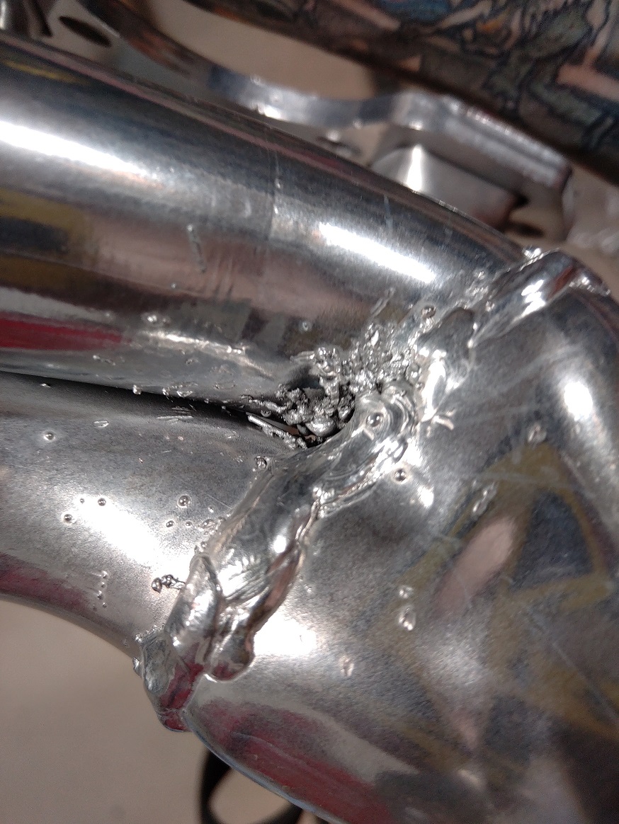

Decipha will prob appreciate this... You were right! :) I did have an exhaust leak.
It never occurred to me that I'd have to check the welds of the pipes at the collector of the brand new HTC coated Hedman headers, Part# 86476. The passenger side has a really bad leak in a couple spots from some truly terrible welds. I'll spare the BS story between but I have a new set of the same exact Hedman headers made at the same time/place the last ones were since they have production dates laser etched and this part# only comes from the CA facility. They have the exact same terrible welds, and it leaks the same. The new set even came with a pre-installed NC whistler in one of the pipes :D :\ I have a 3rd replacement set that'll be here eventually so we'll see if it's 3 for 3 fails or just 2 out of 3....
I attached pix for your viewing horror of the leaking welds but there's spatter and rust all over too. You can tell the weld prep work was non-existent here. Both sets made in 2022. The "used" set has about 6-800 miles and the new shiny set hasn't been used ever.
