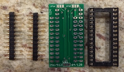

I've always thought that a simple PCB with pins and a socket. Could adapt for any standard EEPROM. We could even build in a header for programming/tune switching on the fly. This could eliminate the need for a xilinx chip.

The point I am making is referring the weird pin out of the EEC-IV PROM/EPROM. It could be removed and adapted using a small PCB with pins soldered in it's place that routes to a standard pin out dip socket. This would be an extremely cheap part and would only require readily available EEPROMS.
Re: MOATES -- FYI
Something like this:

The Ford memory chips are custom and use eight parallel bidirectional tri-state address/data lines (typically called the MBus) and three asynchronous output control signals to determine the direction of the transfer, the type of data transferred (address, instruction, or data) and timing of the transfer on the Mbus. These memory chips are not available for the public to buy and is why the J3 devices use programmable gate array devices to interface a standard ROM chip with the EEC.
