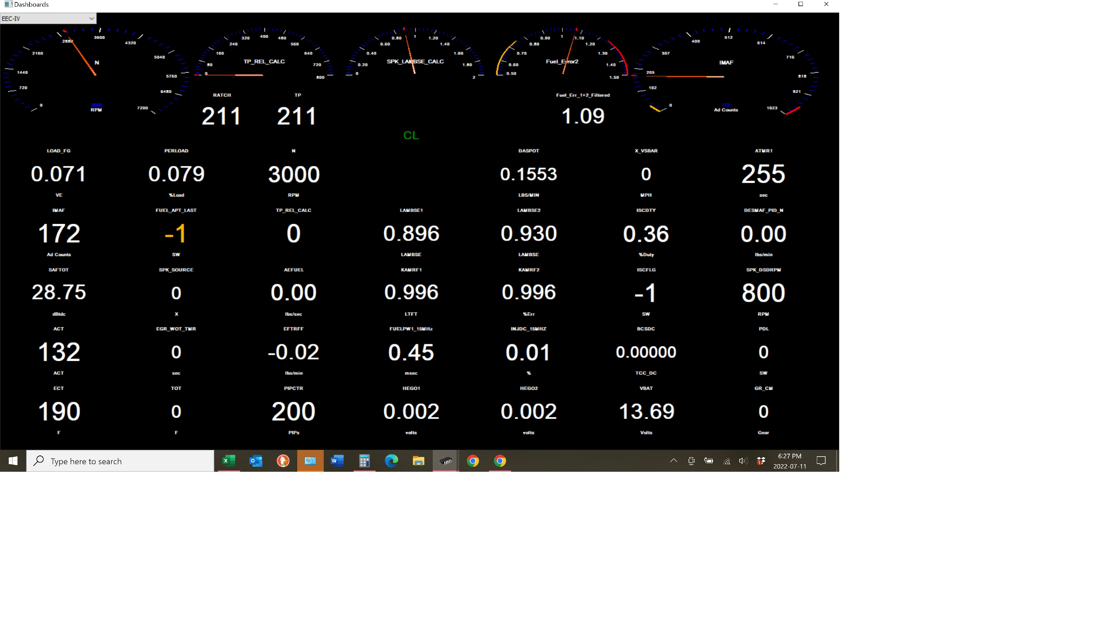

OK, I guess I'm going to need to review what to do. Here's a pic of dashboard at 3000 rpm, closed throttle decel, .071 load. It does look a lot like my injectors almost shut off at decel.
Sean
Sean

just to follow up on my end I did go double check and as expected the patch for this has always been enabled, I am using the most up to date files. After enabling fn338 I have been very happy with how it decels in OL that I have not tried to mess with it again.
Like canuck just said above my injectors almost shut off on decel so the WB goes lean and lambses ramp rich. Is the goal to try to maintain stoich on decel? If so I was going the wrong direction with the airmass correction table as my focus was trying to correct after the decel

no my WB almost always goes full lean on decel which I think is DFSO
