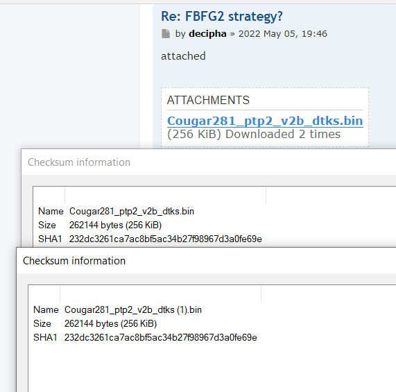

try v2b posted above u never downloaded it to verify

decipha wrote: 2022 May 05, 21:05 try v2b posted above u never downloaded it to verify
Yes I did, not sure why it says I didn't. That's the one that I was referring to in my post at 19:58 (central time).
Posts: 6825
Re: FBFG2 strategy?
that means u downloaded thebwrong file go ahead and give it another download and try

Re: FBFG2 strategy?
Unread post by Cougar281 »
No, the 'Cougar281_ptp2_v2b_dtks.bin' file you posted at 19:46 Central is the one I downloaded, and it's working pretty much exactly like the MGZT file with the fuel pump modifications. Which is good. I'll just have to try to figure out why the start/idle is different from the PTP2/FBFG2 tune - could be a MAF scaler or something as earlier today, when I was looking at my original PTP2 and the MGZT tunes, the MAF scalers did seem to be different. Not by a ton, but it could be enough.
Posts: 6825
Re: FBFG2 strategy?
thats not it
9 posts up
