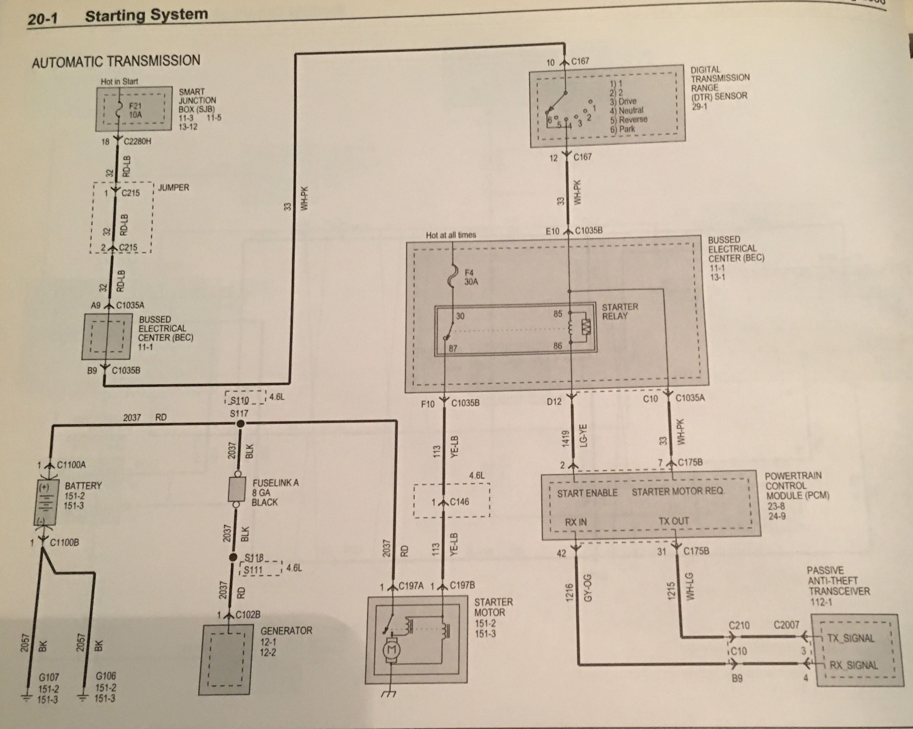

I hooked everything up,I tied into the wiring harness of the mustangs PCM for close proximity.
I took out the Mustangs PCM and benched it.
All that’s in the car is the Mark8 ECM and it’s harness.
I go to turn the key, I have acc power everywhere, but it won’t turn over.
The PATS system is in the Mustang from factory
I’m wondering if that could be the issue?

Re: 2006 Mustang & 1993 MarkVIII engine and transmission
The Schematic is for an 06 Mustang
Pguercio1
- Posts: 22
- Joined: 2021 Aug 22, 22:46
- Location: Edmonton Alberta Canada
- Vehicle Information: 2006 Ford Mustang with
4.6l DOHC from 93 Mark VIII
Michael,
How do I bypass this starter interrupt at the original PCM Connector? Are you saying the Mustang connector?
Which wire should I ground?
- Posts: 6953
You just posted it
pin 2 is the ground
pin 2 is the ground
Hi Michael,
I grounded PIN number 2
And still nothing!!!
I have accessory power, I have lights, heater,
Windows, locks, power seats all working;
but when I turn the key to start position
‘nothing’ like a dead battery.
(It’s a new battery)
