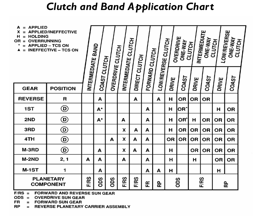

Nice! It works and is much cleaner code. It still freewheels on decel. It would be nice to have engine braking, but I can always put it in manual low if that is not possible. I believe b7_Ra2 this is the coast clutch bit but based on the clutch application chart it should already be applied.
91,80,a2            orb   Ra2,80           B7_Ra2 = 1;
Another final step is creating tcc lock/unlock points based on vss.

I will double check. Here is the logic in KID2 with named addresses. I am trying to determine if the coast clutch is disengaged in this case.

My brain hurts. I tried setting TM_CS_ENG to TMCSE3 and it's back to disengaging entirely on decel. Not sure if I'm up against the physical limitation of the transmission or my code is hosed. Either way mission accomplished so thanks for all the help.
