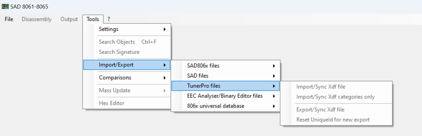

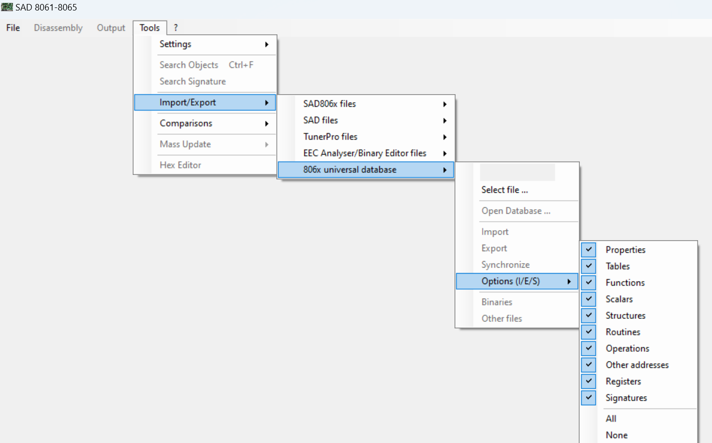

Anyone used the SAD806x windows gui?
The developer goes by the name 'thepym'.
Windows executable here: https://github.com/OpenEEC-Project/SAD8 ... master/Exe
It has built in database to save info like what is in the above spreadsheet.
And has built in create XDF file for TunerPro.
I had it working a couple years ago, wasn't perfect.
I'm wondering if using this tool is better for managing multiple bins.

I have used it but it will not but it will not disassemble some bins.
