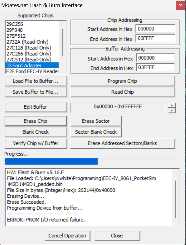

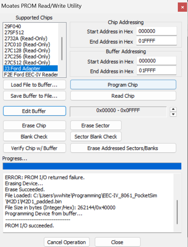

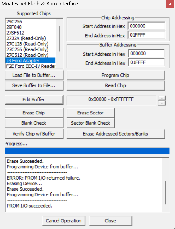

This is driving me nuts!
Not sure what I'm doing wrong.
Burn2, TI J3, have padded bin 0189 order, 256k file.
Can someone give me some guidance?
I purchased these TI J3s a while ago, cannot get a single byte of data written to them.
M2D1_padded.bin
EEC-IV Padded 0189
(256 KiB) Downloaded 563 times
Not working 256k
Not working 256k
Not working 256k
Working, small amount of memory, 0xFF written:
Working
Working
Bank 0 and 1 working
Bank 0 working
Bank 0 working

Try 00000 - 3FFFF

jsa wrote: ↑2025 Oct 28, 07:04Try 00000 - 3FFFF
That is the first image: Not working 256k
