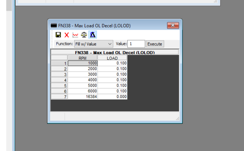

I'm not 100% sure how to setup fn338, does this look ok?decipha wrote: ↑2022 Jun 14, 11:45 in dfso it will be in open loop so it wont ramp at all
for now your best bet is to set fn338 to force open loop on decel at those rpms and then you can very easily dial in the decel correction table
make sure the decel table is set to be used at closed throttle at wot only.
Looking into this more did I go the wrong way with load? Found where this is touched on in the write-ups and it reads that the load should be higher so OL is for below that load. I am also not sure if there is a reason to have different loads at different rpms? I think I want it to go into OL all the time on decel which is why I put the same load in all columns.
I am not sure on how to verify if the decel table is set for CT and WOT only. I am using the latest files so is it setup that way to start or is there something that needs to be changed to make this happen?

- Posts: 6771
Re: Controlling lambse on decel
no thats corrupted and you dont have tunerpro setup correctly
see the getting started write up

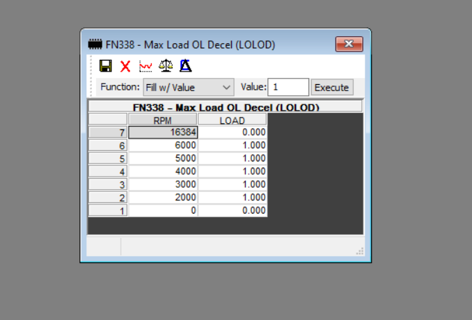

got tunerpro setup, hows this one?
