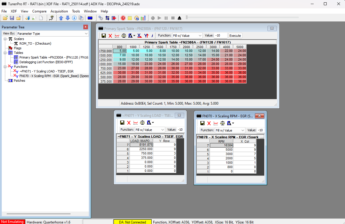

working on some timing stuff. The load scaling is strange to me. Is this a MAF setup? I may be looking at the wrong load function.

yeah I believe C268 (a268) is the correct function. I will update soon. what is a usual load range for MAF?

I think I should be using a different strat as a template instead of A1C. Anyone know what the closest XDF available would be for this vehicle? It is distributorless with a cam synchronizer if IRC

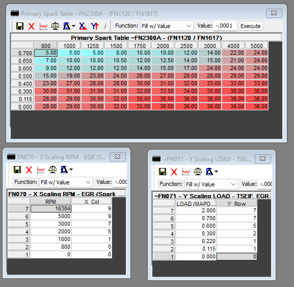

yeah this looks better:

yes it is maf

efloth wrote: 2025 Jan 21, 15:48 yeah this looks better:
Much appreciated good sir!
