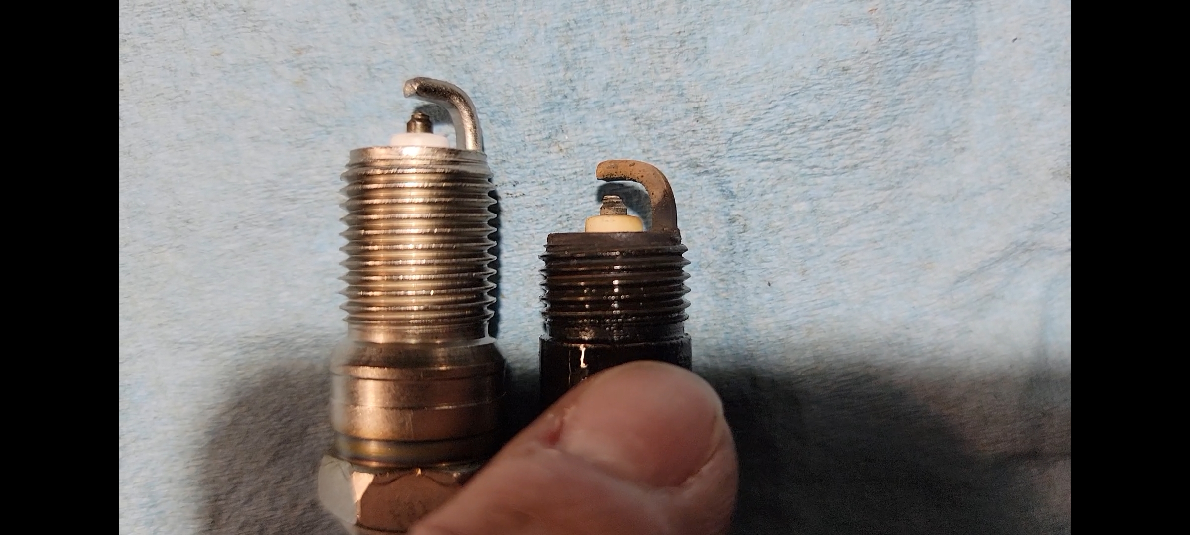

Well im pretty sure my issue was having the wrong spark plugs. I reused the Mark viii plugs because they were new. After thinking about it for awhile it donned on me that the B heads are 4 thread and my C heads are 9 thread. So i changed the plugs and discovered half of the plug was not in the cylinder and the plug was seated on the end of the threads instead of the tapered seat. After changing the plugs the car idle way better and the noise is no longer there.
