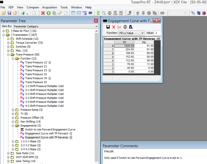

Reverse Engagement Curve or FN616R, but switch to use Engagement Curve has to be set.
Not sure if your xdf has that or not, but speaking from the CZAJL strat, it works.

Doesn't have it yet, but it will. Thanks so much, the FN616 is leading me in the right direction.
STALLTV_SW = Calibration switch to select FN616 during engagement;
	0 -> select FN616,
	1 -> do not select FN616.
	FN616(TP_REL_H) = Stall TV pressure.
With your hint of FN616, also found these FN46(forward to reverse engagement) and FN56(neutral to reverse engagement).
Since the truck shifts in reverse perfectly when cold, I'll have to do some data logging on some of these parameters and understand it before I change anything.
Hmmm, your parameter comments are backwards for what LHBH1 strategy states.

That makes sense. As CZAJL is a bit strange in some ways I've noticed.
