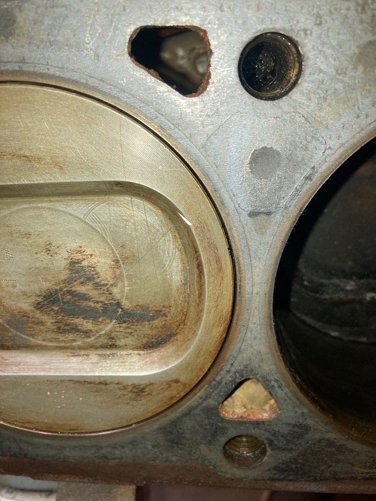

WIth any head/cam swap you should be checking PtoV clearance regardless.
I'm putting 2.02 Eddys on, and PtoV on exhaust is fine, intake is super close, showing 0.050" radial valve clearance with stock pistons 1994 351, with 0.533 intake lift, 1.6 rockers.
Sooo, some might say I'm fine if not turning more than 6,000rpm.
I'm not taking a chance, going to cut .030 off the piston using a 460 intake valve I have laying around with some grit attached to the valve face.
Here is a picture of what I need to grind out for radial clearance.
This nick in the piston is from pushing valve down by hand. As I was checking clearances, from -10 to 0 to +10, this happened at about 8 degrees crank.
