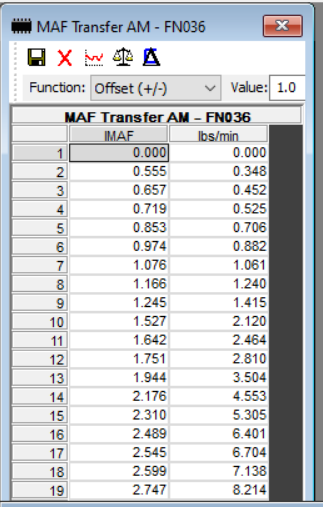

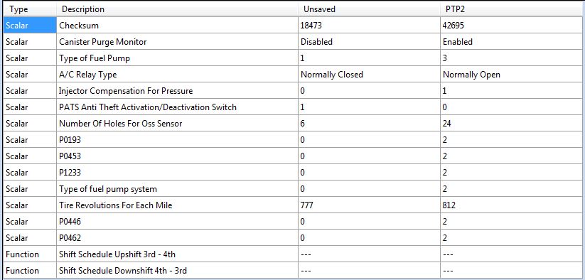

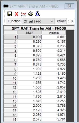

So I've been fiddling with this in my 'spare time', and my original PTP2 tune runs the car noticeably better (except for the fuel pump behavior). Comparing the tune I've been running to a stock PTP2 tune, the attached image shows the only changes. The driveline in my car, from MAF to downstream O2 and crank pully to transmission output shaft is 99-04 Mustang GT, so any stock Mustang GT tune should tune should run right. In poking through the FBGI0 base 'PTP2' tune posted, there are a lot of differences - MAF, IAC, etc. Take FN036 in the attached images - quite different. Any ideas? Shouldn't a stock, auto trans FBGI0 Mustang GT tune match a stock auto trans FBFG2 PTP2 calibration and run the car the same?

the maf transfers you posted are both the same, in my head they come out to the same value when you interpolate them
fbgi0 is for euro spec so a touch different than us

To be honest, I haven't driven it with the FBGI0 tune. But just starting is noticeably different. The last tune you posted doesn't have as much of the 'runaway' that the original version had, but it stumbles on startup, whereas the FBFG2 version fires up smooth. If the FBGI0 tune is set up for premium and a hot cam, then 87 and a stock cam would likely not work too well without changes. I didn't realize it until just now, but the FN036 table has 30 rows, going from 0 in row one and both columns for both tunes, to 5.120 in both tunes for 'IMAF' but 44.828 in the 'lbs/min' column for the FBFG2 tune and 40.858 for the FBGI0 tune. I'm not exactly sure what you mean by 'they come out to the same value when you interpolate them', but my guess is you mean the ECM can calculate values in between rows of the table, so for example, 1.944 IMAF on the FBFG2 tune would calculate out in to between 1.875 & 2.0 (rows 15 & 16) on the FBGI0 tune? If that's correct, the only question there is would the 4#/min difference at the top end make a difference in how everything's calculated?

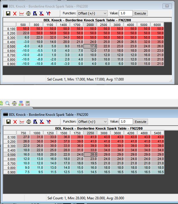

I'm not exactly sure what spark tables would need to be modified, but I looked at FN2200 (Borderline knock), which appears to be the only one referenced in your 'minimum values' list, and they're definitely different. At .500 and 2000 RPM on the FBFG2 tune, it's 17*, but on the FBGI0 tune, at the same cell, it
s 28*, but I also noticed on the FBFG2 tune, the RPM columns go from 500 to 6000 in 300RPM steps until the 2000 column, then increase steps from there until 6000, but the FBGI0 tune goes from 750 to 5400 - will a copy and paste from the FBFG2 tune work with the column differences? I also looked for 'Dashpot', and lots of differences there, which may not mean anything specific - is there one specific table or value that is the 'key to it all' that would need to be changed?

For now, yes, I'll probably run the FBFG2 tune, but at the very least, I want to keep the FBGI0 tune 'on the back burner'. Maybe as I read and learn, I can iron it out. The Fuel pump is the biggest annoyance on the FBFG2 tune though. Any ideas why the it work 95% on the FBFG2 tune, but 100% on the FBGI0 tune?
