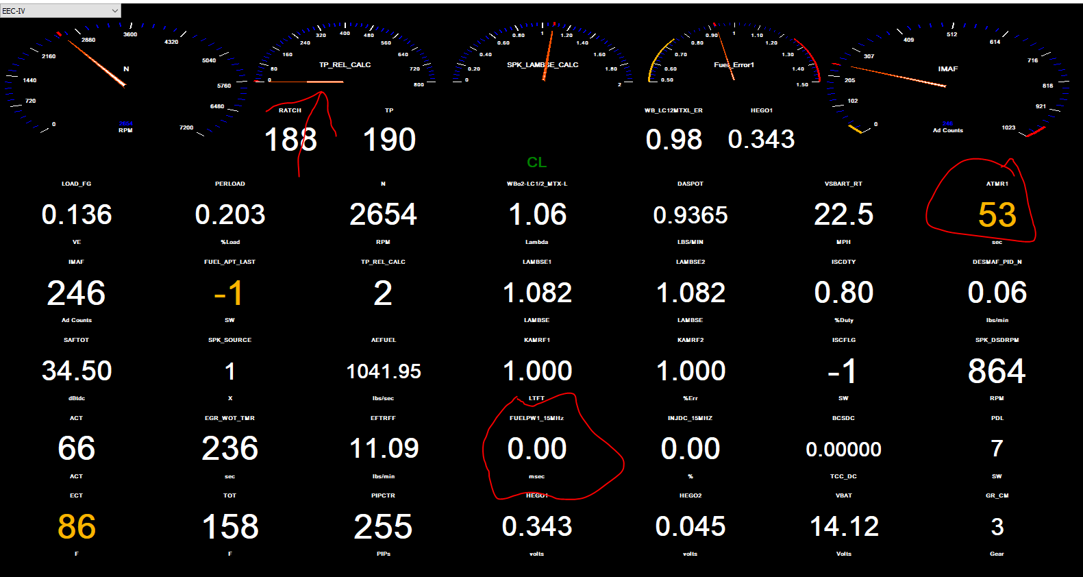

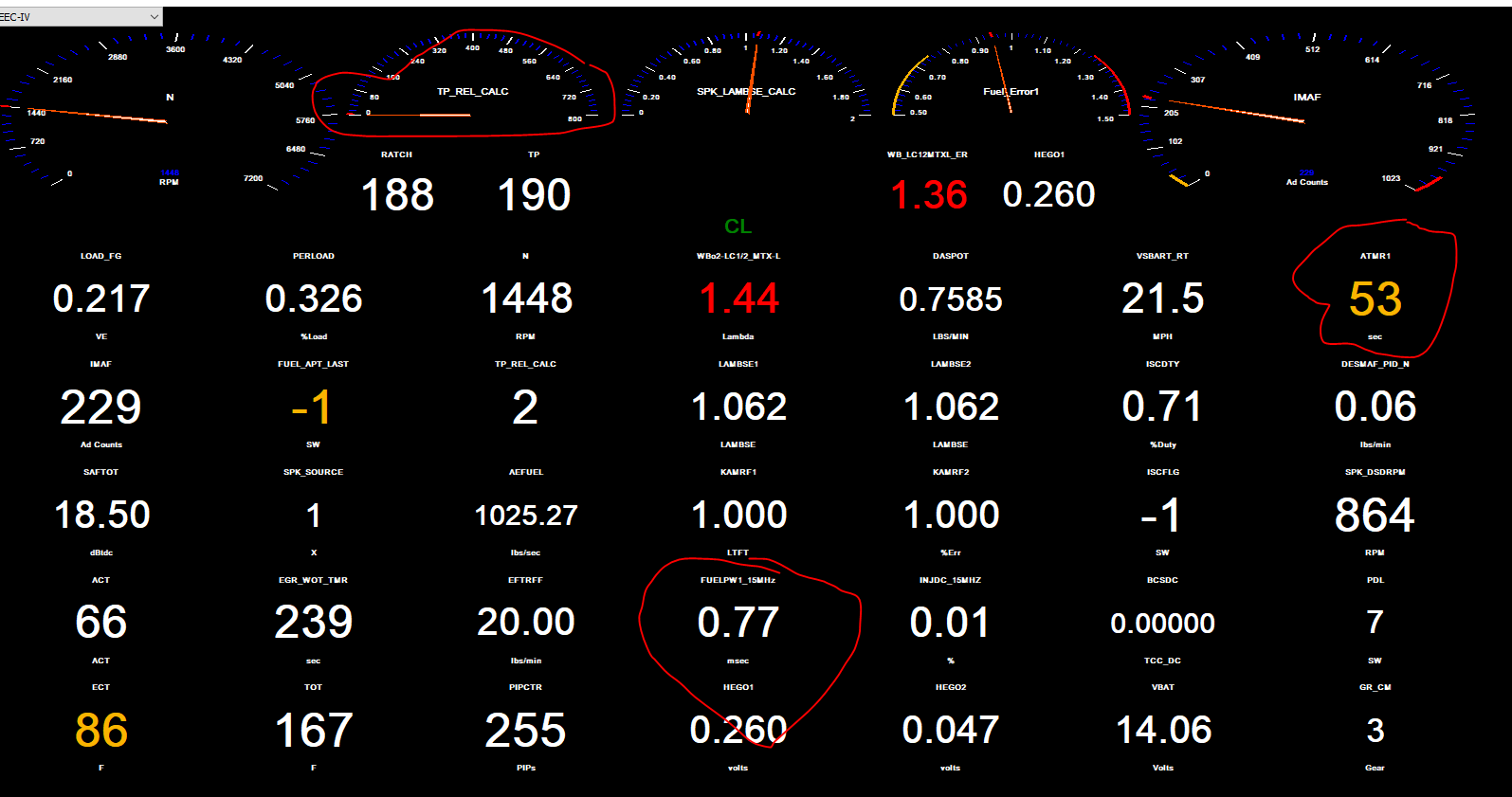

Went out and drove it today and it still hits 1.5 lambda on decels between shifts when cold. I went as far as set the decel time constant to .1 and it still hit 1.5 when cold. Is this a case of it going into closed loop too soon maybe?
- Posts: 471
Re: Ultra rich as engine decels
The datalog clearly shows the injectors are shutting off at decel. With the .1 decel time, I can see the injectors go to 0 pulsewidth for about the same time the decel time is set to. My datalog captures 7 cycles per second and its 2 cycle difference from 0pw back to seeing pulsewidth and about 4-5 cycles before the pulsewidth is above the ford recommended minpw. I just checked my tune and I can see that the MinPW is set to .099 which is way lower than the ford spread sheet of .599. I changed it to .599 but it changes to .401 after its saves so I guess Ill see what happens with that. I attached a couple screen shots showing the dashboard. I also don't understand how the pulsewidth drops below the min pw setting. I get 0.00 with a min pw of .099 so i don't feel like it's the problem and something else is shutting them off.
