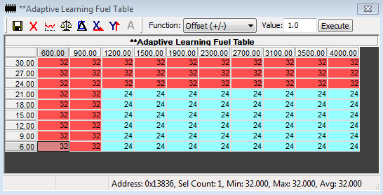

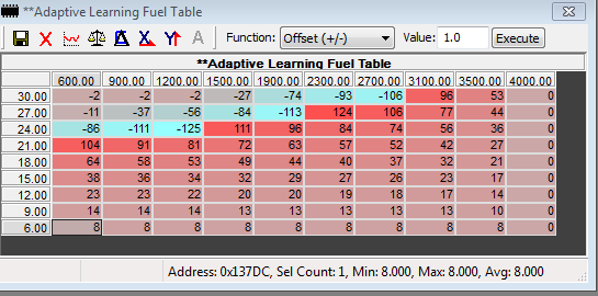

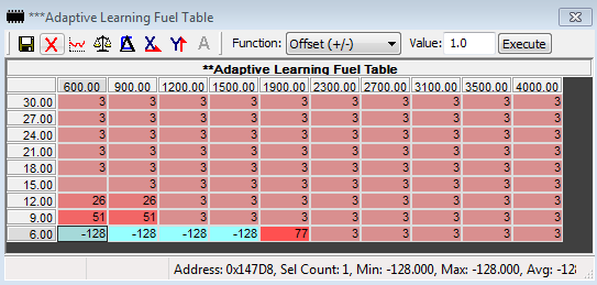

in addition after i ran the SAD i had had look in the _lst file... it seems to have found about 70 tables.. (this was before actually following the decipha instructions. .. all i had done was run the SAD and it produced the lst and the msg files)
so went through them and compared them to where i thought some of my tables should be,...
i found my addaptive update table wasnt a table (as list in _lst).. lst just reports it as "14130 -> 1415f = 0x3 ## fill ## "
so i had the adaptive table as just all 3's.. yes it seemed strange .. but hey how do i know what is normal..
i believe the addaptive update table should be 10x9... _lst found 4 lots of 10x9 tables but when looking at the data contained in them they dont look right.. eg the 10x9 table at 147D8 has 4 cells with -128 values ... this makes no sense as -128 would mean reference row 12 column 8 presumably or heck it could even mean row 1 column 28 ... there are not 12 rows and there are not 12 columns either in this table..
my other options dont look right either..
ive attached pics of the tables if you want to look at them..
but it does seem i half right on the track..
Yep, hence 40716 dropped the faulty function and table methods.
Functions scale the row and column counts. Work backwards from the table lookup inputs to find the row and column counts.
Once you know exactly what they are put commands in the DIR.
