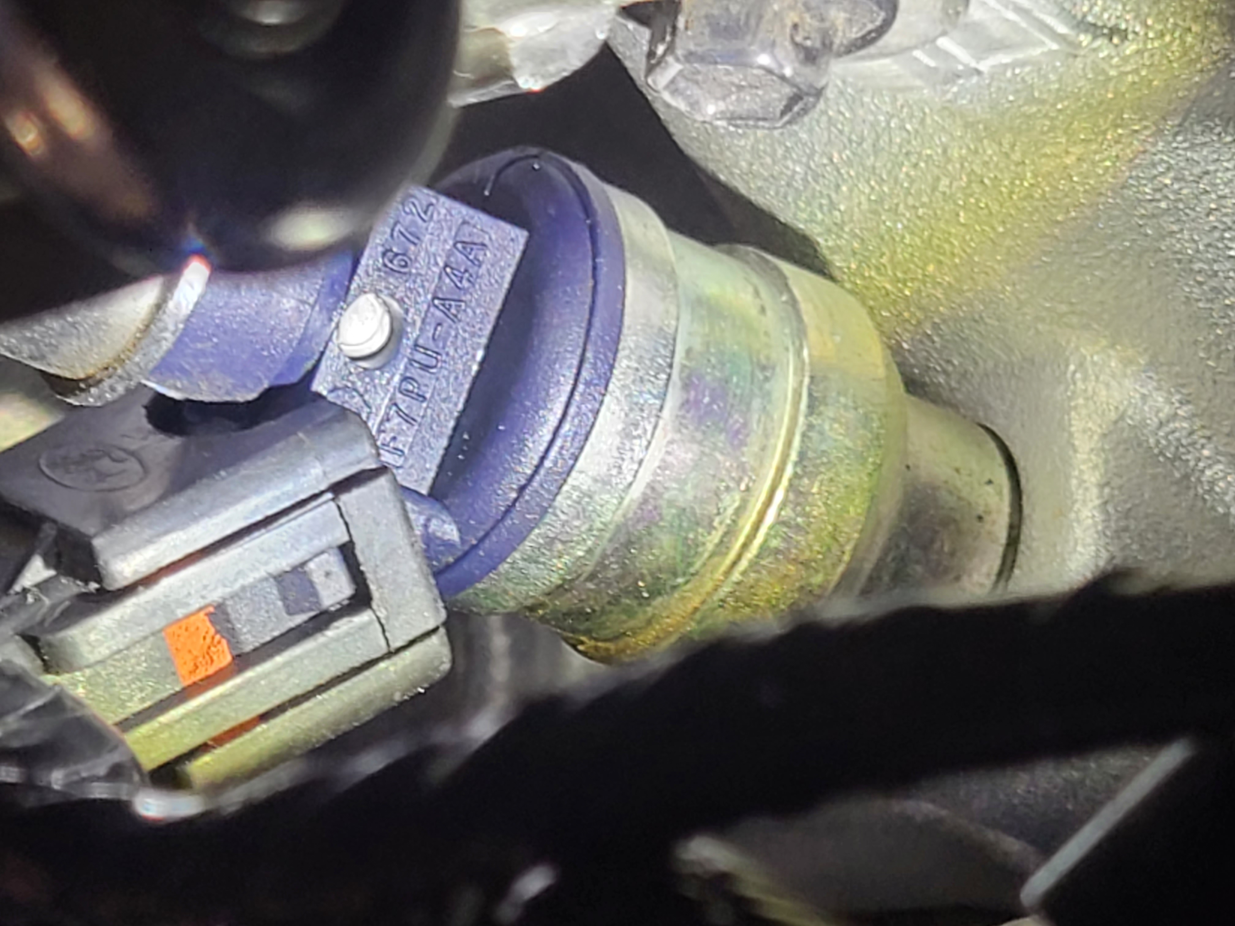

Just checking to see if there is data available for the following numbers. FU7A- A4A, I think there may be a FMS 36lb injectors.
Re: Injector Data needed
your missing some info there
whats the full part number?
what are they out of?

Not sure what there out of, customer of course bought them used and doesn't know anything about the injectors but was very proud that he only paid 200$ for his maf and injectors lol

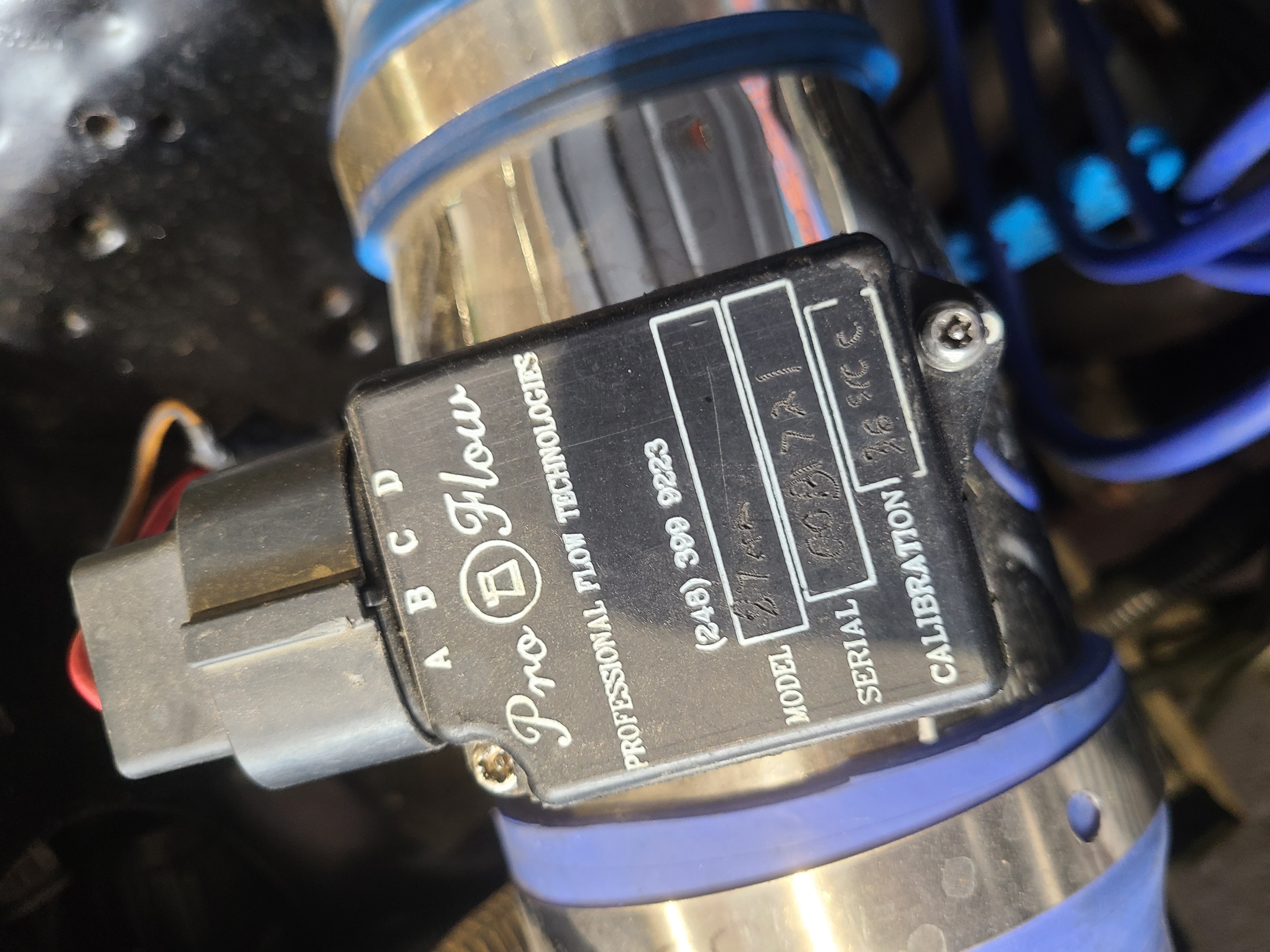

I do believe they are a 36lb injector that this maf was calibrated for. This maf and set up is super unstable with swings in imaf 20-30 points each way

They may be counterfeit. ( They faked part of the pn but not all? ) The F7 tells me it's from a 1997 Ford but that doesn't narrow it down much.

Yea that's what I was worried about tbh
