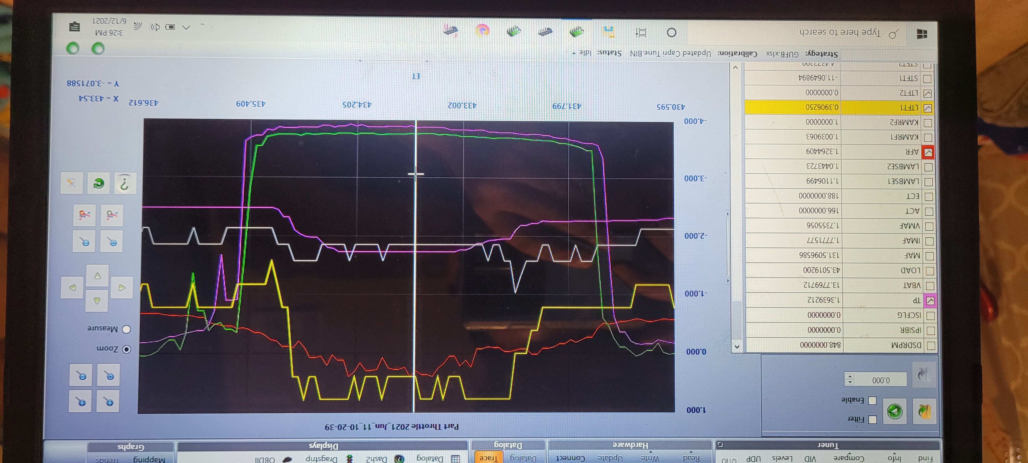

So I've been fighting a part throttle lean miss for awhile now. It happens at light throttle below 2k rpm. I've been going on datalogs today and noticed that the LTFT1 is actually lean at those spots. LTFT2 is not. Any ideas why this is and if it could cause my lean issue? I know most on here is tunerpro so I'll post up pic of the log.
