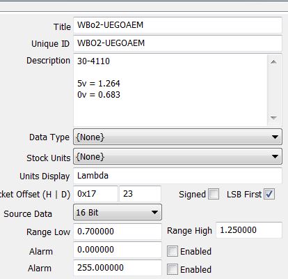

I have the AEM WBo 30-4110 and the scaling is different than what is listed. How do I change the formula to correct the value? How do I convert it to this 12800 formula from 0-5V? I have done the conversion and there is a few percent difference at Lamba =1. The value listed is 0V = 0.683, 5V = 1.264 and the values that came with the gauge are 0V = 0.683, 5V = 1.366.
Transfer Function:
A9L2: Lambda =(1.264-0.683)/5*V+0.683
AEM: Lambda =(1.365-0.683)/4.99*V+0.683
Transfer Function:

Thanks, I couldn't wrap my head around the conversion to Ad counts.
So if anyone is interested, the transfer function for the current AEM 30-4110 is:
(0.1367*(x/12800))+0.683

Re: Getting Started
plx its already in there
