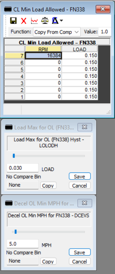

Hi all, I've been trying to get OL Decel working ... and am having a bit of a struggle.
I set up FN338 as per below, but despite the driving conditions satisfying the criteria to get low load cruise and decel into OL, she never drops into OL.

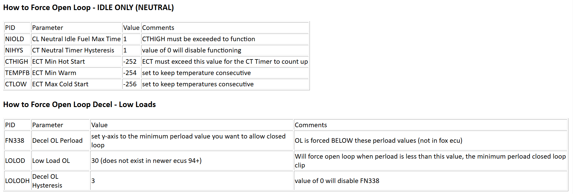

I do have Idle working in OL ... per the instructions in the Tuning tips section:
Wondering what I'm missing here ... does the setup for OL Idle interfere with OL Decel. Would OL decel inherently force idle into OL? Apologies if this is far more simple than I'm making it ... but can't get it to work for the life of me.
