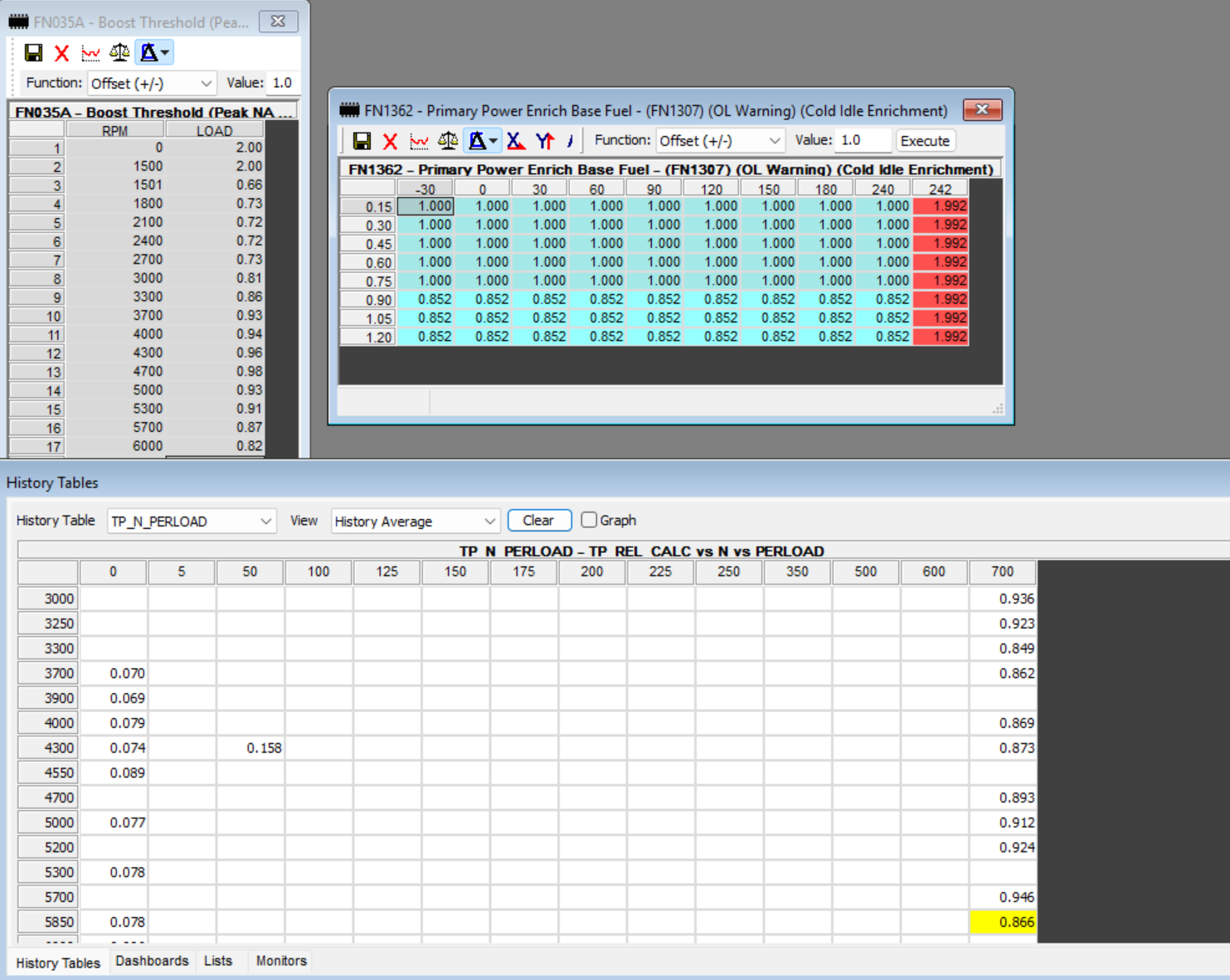

At WOT im seeing some lambse numbers that are very rich, trying to figure out why. HEGO's being pinned rich also confirm that it is rich. I think its all from PERLOAD being off? Itll dip into the .7lambda range at tip in and as you climb in RPM. Data logged and looked at the TP_N_Perload histogram. Looking like my FN035A values all need to drop, but is a VE/Load 87.514 reasonable at peak? Low RPM im seeing numbers that would put me in the 60% range.
Considering the cam is the same, and there is more cylinder to fill, a drop in VE isnt unreasonable correct?
Short pull attached. Itll pull up to 6700rpm, this i shut off short just to get decent data for PERLOAD

You got the right idea but you need to reduce fn035 by the sarchg difference as well. SBF's are head limited engines so anytime you increase displacement your load is going to drop with all else being the same since the head can't flow anymore.
Your tune is corrupted, you have some code changed in the pip routine that shouldn't be.
The lambse is .1 richer than operating temp since the engine is still in startup enrichment.
Here you go, this is your last tune updated with the newest code and adjusted for the 331.

Thanks! Makes total sense on head limitation dropping load. Going to compare the Bins in Tunerpro a bit before i ask any more questions.
