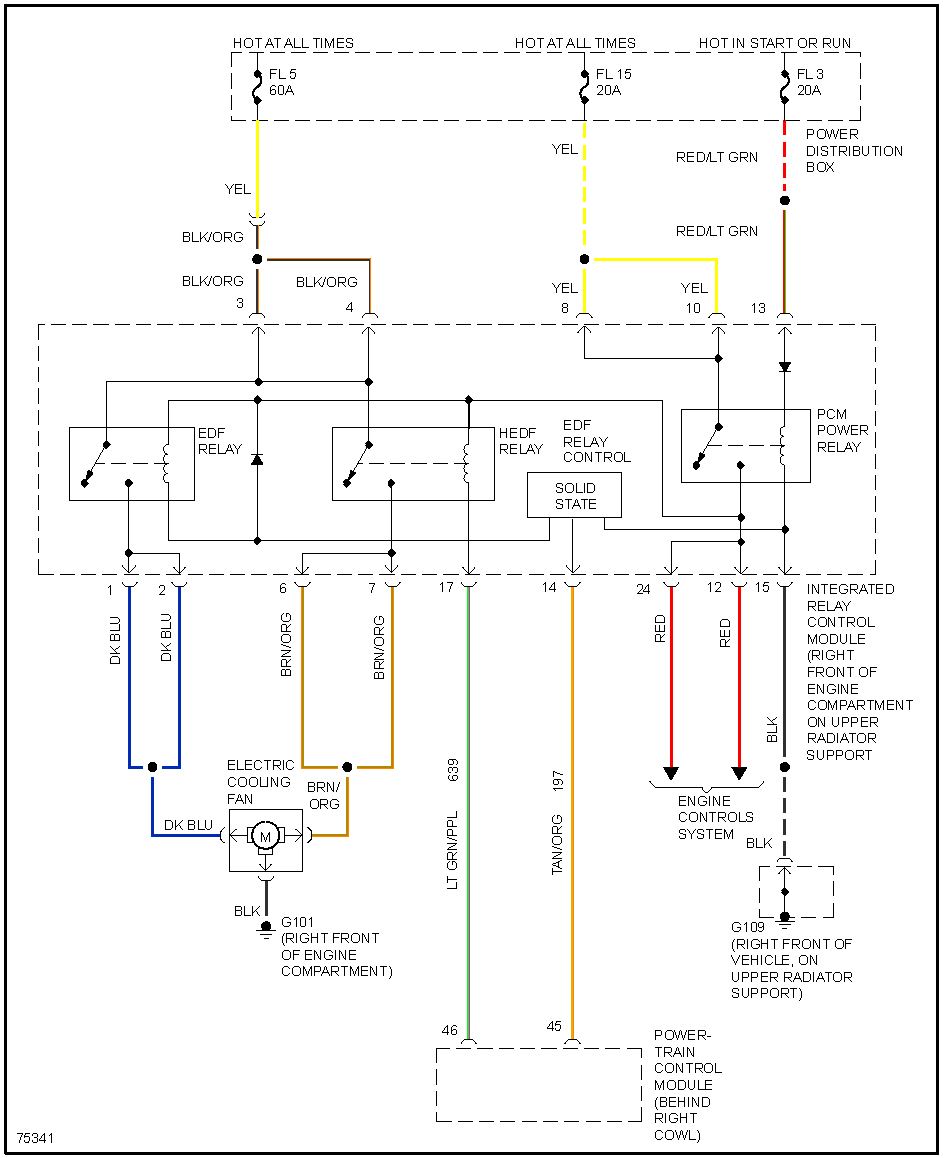

So it seems I mis-remembered. With the Marauder PCM, it only has one speed, but it sounds like the high speed fan. When I turn the low speed fan on, the fan turns on.
Looking at the fan circuit schematics, the low speed fan wire goes to what's labeled 'solid state', which has a ground connected to the PCM Power Relay's ground, and then a line going over to the EDF relay. When the wire is removed from the connector or the pin is changed to another one for the LSF, the fan turns on, indicating the PCM is actively stopping the fan from running so that it's 'fail safe' in the event something went wrong in the PCM or the wire was severed. Looking at the schematic, it looks like the PCM pulls the fan controls to ground. In the case of the EDF relay, it appears the PCM pulls to ground to turn the fan off, and for the HEDF relay, it pulls to ground to turn it on.

yep, thats how they all function
i'm not following how any of that is relevant?

Re: Generating a tach signal to drive stock tach?
Just making sure I'm understanding the theory of operation and that the fan lines are wired correctly... When I was moving the wires, based on the diagrams and wire colors, it looked like the two were reversed, but when I swapped 45 & 46 (after changing the output in the tune), fan was on immediately at key on, so since the EDF relay is turned off by the PCMs output and the HEDF relay is turned on by the PCMs output, then it's wired up right and operating correctly.
