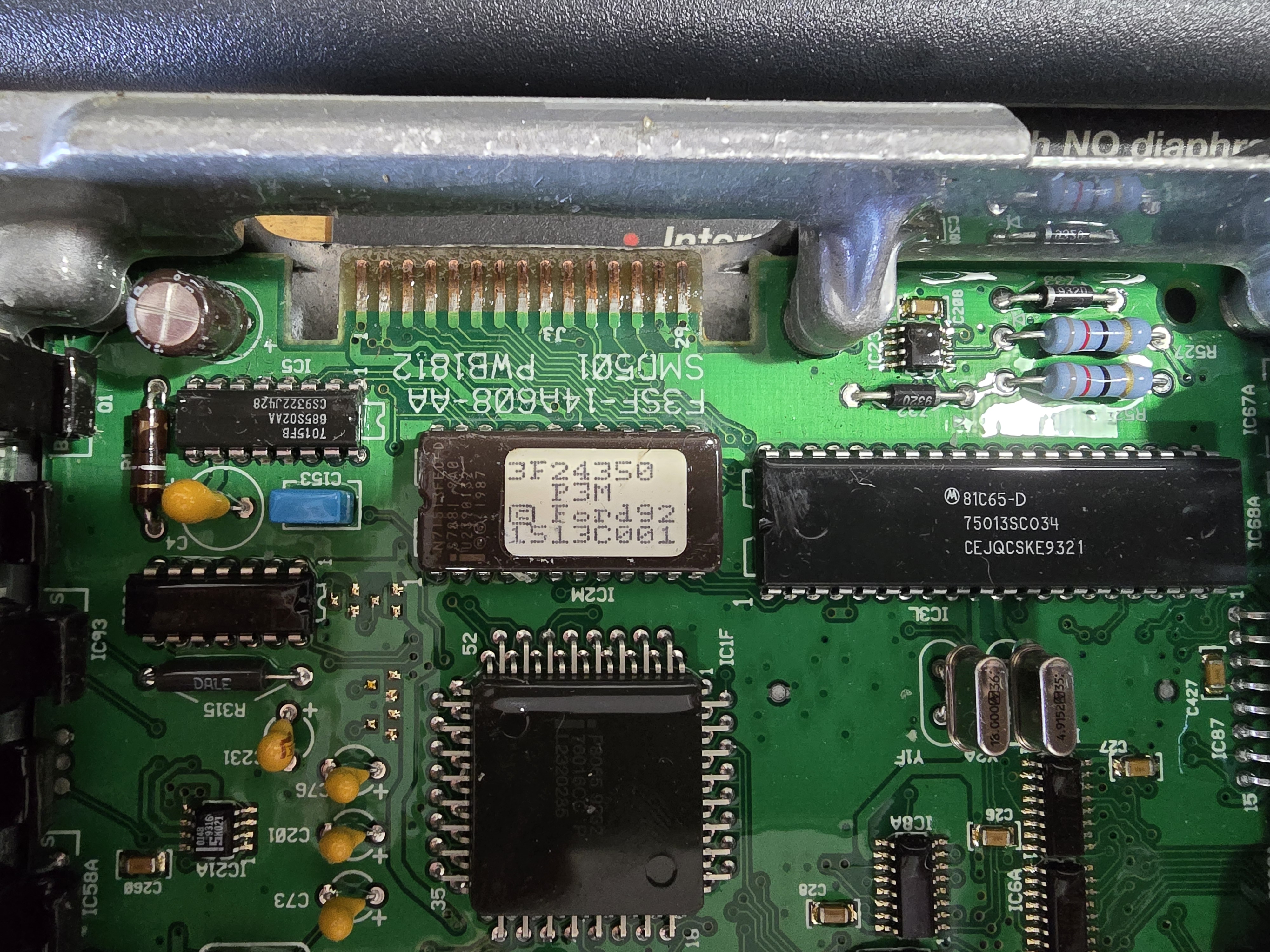

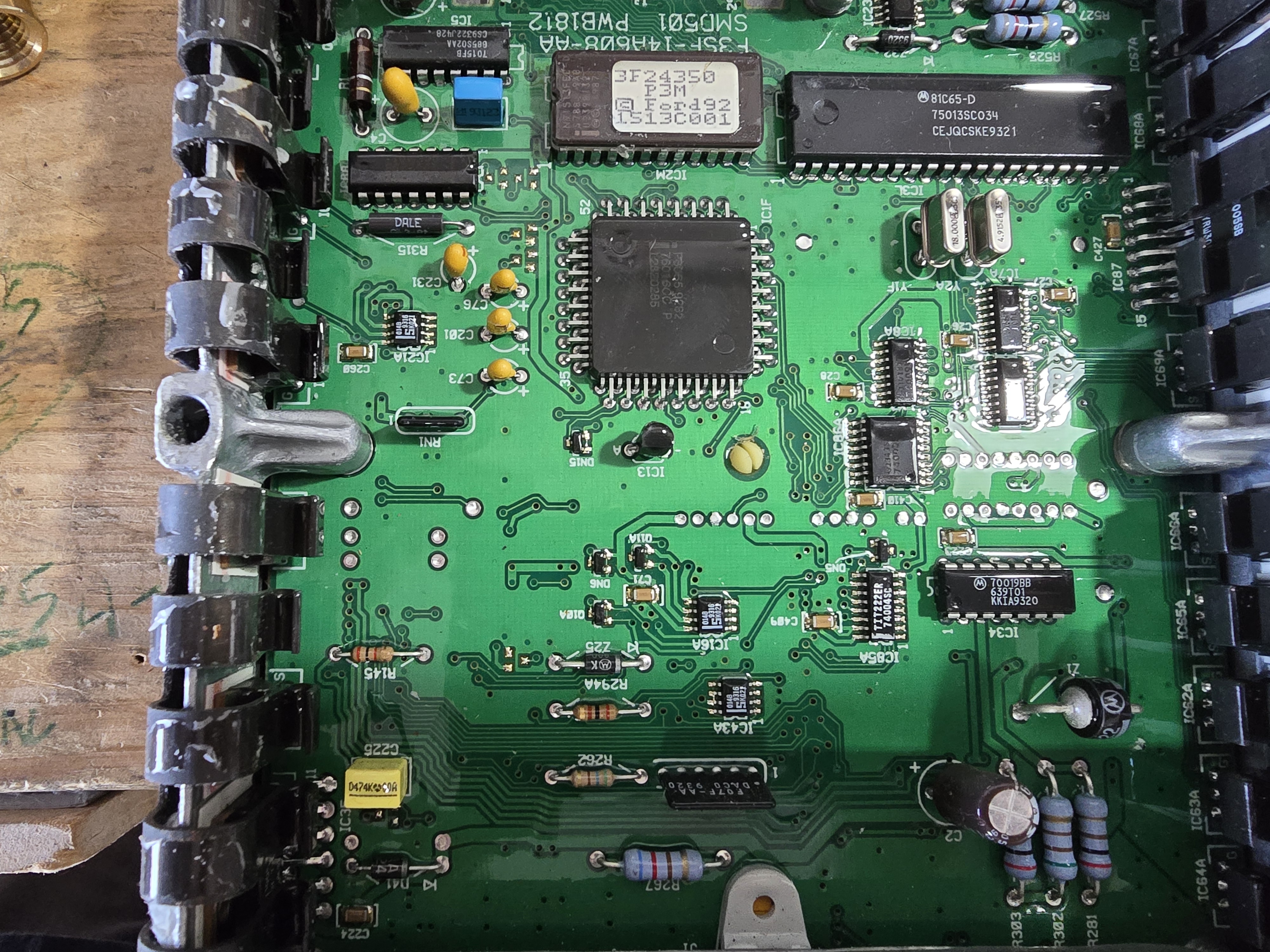

MAF xfer is at xA570 in P3M.
What's the clock frequency for the 8065 in P3M?

- Posts: 458
Re: Can I get verification here??
Post up the DIR with what you know in it.
What's written on the oscillator inside the EEC box?

I have 8C08 for AHISL and 8C0A for ALOSL at 0000 offset. When you read it out in Burn2/Moates like you would address a normal 56k, it lines up with a bin size of E000 and 0000. Offset on the XDF. For burning TI chips, 40000 bin size and +22000 offset for 256k.
Looks to be 18 mHz.
Looks to be 18 mHz.
- Posts: 458
Re: P3M stock value verifications vs X2P
Yes, 18MHz so ~36lb/min maf max.
