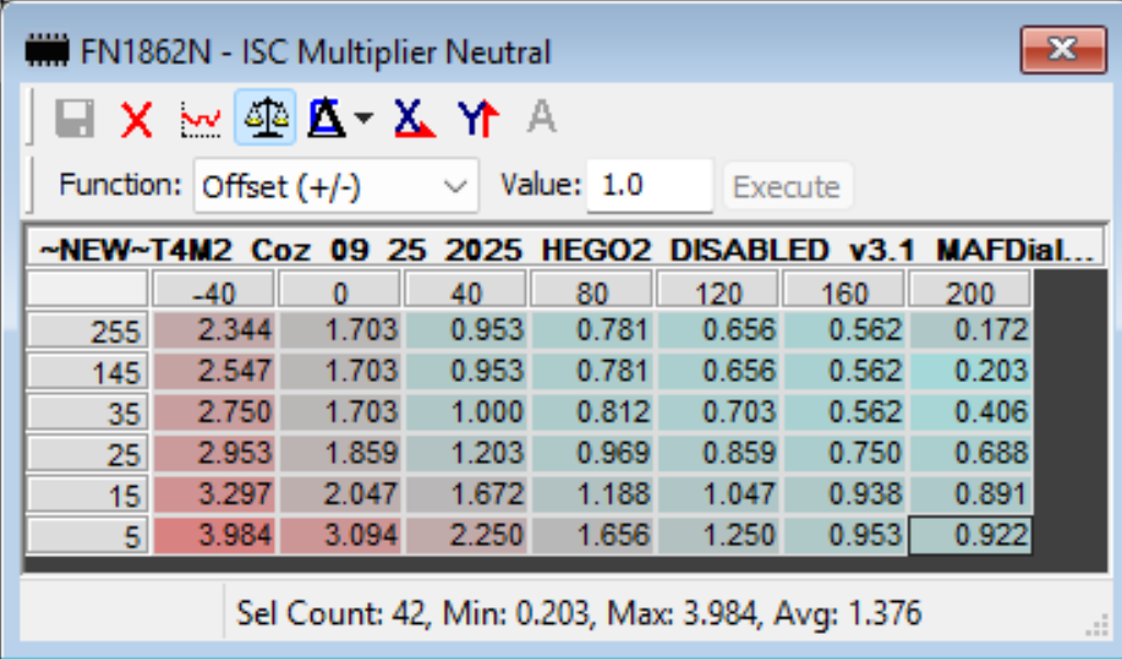

Would you be able to confirm that the default values for FN1862N in your T4M2 base file are geared toward Mechanical Idle? Here's a snap of the default values in T4M2:
If this is for mechanical, should I just lift some starting values from J4J1 or T4MO. I will be tuning startup air regardless, but figure that starting with the right-sized values will save me alot of pain, trial and error while tuning this one cell at a time, at specific temp and runtime.

that was back in the gap, if youve dialed it in then no reason to not use it but since you hadnt might as well just simplify it.
apparently i never posted an updated t4m2 file. Ill toss one up first chance I get.
