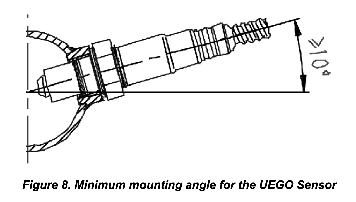

decipha wrote: 2025 Aug 30, 09:41You want it on the upper half of the pipe so if you envision the pipe was being half filled with water the o2 wouldnt get wet.
If I envision that, then I would think the O2 sensor needs to point up, which is incorrect. You want it pointing down a little, not horizontal, not up, but down no more than 10*.
There will be instructions with the AEM 30-4110 of where/how to mount the sensor.
If the sensor is laying horizontally, you want it ~10* pointing down.
The idea is, that if condensation gets on the sensor, the water will drip off the tip.

Re: AFr gauge
negative
the best location is the sensor on the top 12 o clock
ignore what the manufacturer suggests
