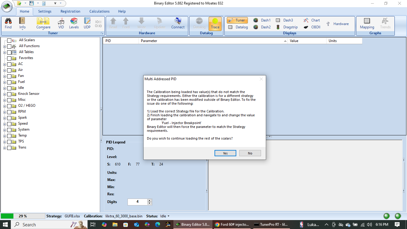

Tried to load it into BE and got this error message (Attached)
UPDATE: It looks like everything loaded, the Fuel-Injector Breakpoint is all zero's except the top right under 10XE-5LB/REV is 8.3629 instead of the stock 3.0398, I'm assuming this is correct?
This calibration doesn't have the FN1036 table so I'm assuming all timing is done in the FN904A Sealevel Table as it's the only one I can find that has values in it (they are much lower than stock as would be expected) **BUT** there are NO load values in the Y axis at all, is this normal?
It looks like from the FN1360 Stabilized Fuel Table that the a/f ratio is set to mid 11's which is what I usually use as well
***SORRY*** for all the stupid questions but just trying to learn & make sure everything goes smooth at the dyno!:)
Re: Ford 60# injector Scaling question & Maf question
yeah you can use it with BE just dont change anything that looks off or wrong as it will corrupt it
stick with dialing in the maf and youll be all good
nope you dont owe me anything
yeah, dont edit the breakpoint or anything, BE isnt going to show the actual value since its custom code
fn1036 is the failed load table, it never existed in the guf strats, its all custom code I wrote so BE wont have it. Its no problem though.
the sealevel table doesnt have a y axis because that table doesnt exist the same way in the custom code. You shouldnt have to mess with any of that though it should be all good.
The scaling though is
