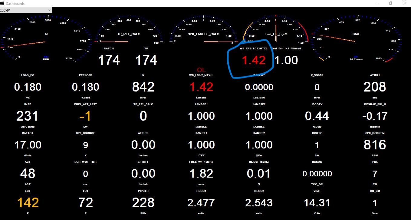

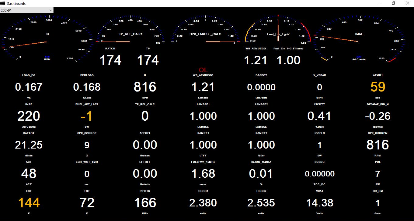

Even though I'm using this program for EEC-V application, can I use the EEC-IV dashboard? The EEC-V dashboard is too big for my two different laptop screens and chops into the bottom row. Also the EEC-IV dashboard appears to have sufficient pids that I need. One simple question though. I need to change the preset wideband on the EEC-IV to my AEM 30-4110. I'm seeing erroneous feedback from the gauge setting being incorrect. I figured out how to change it. Did I make the right choice? WB_AEMUEGO. See second picture.

yes you can usr the iv dash just some things you wont see on the screen and hego voltage will probably display a bit odd depensing on which strategy your using.
you just simply right click on the gauge and select your wideband from the drop down menu. The adx logs all the widebands so it doesnt matter which one you have shown other than to view it.
