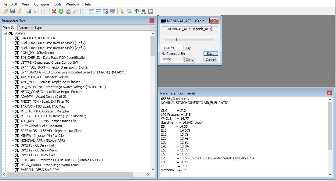

I changed this: and this: (this may have already been set to my fuel choice) You have me looking for this: I would believe that I want to adjust this to make it run richer in Open Loop.
