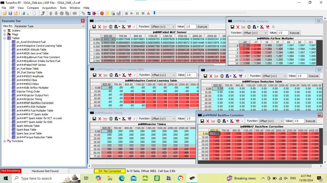

This XDF isn't complete yet as i still need to do the scalers and flags.
1DGA_256K_v5_JM.xdf
(591.98 KiB) Downloaded 683 times

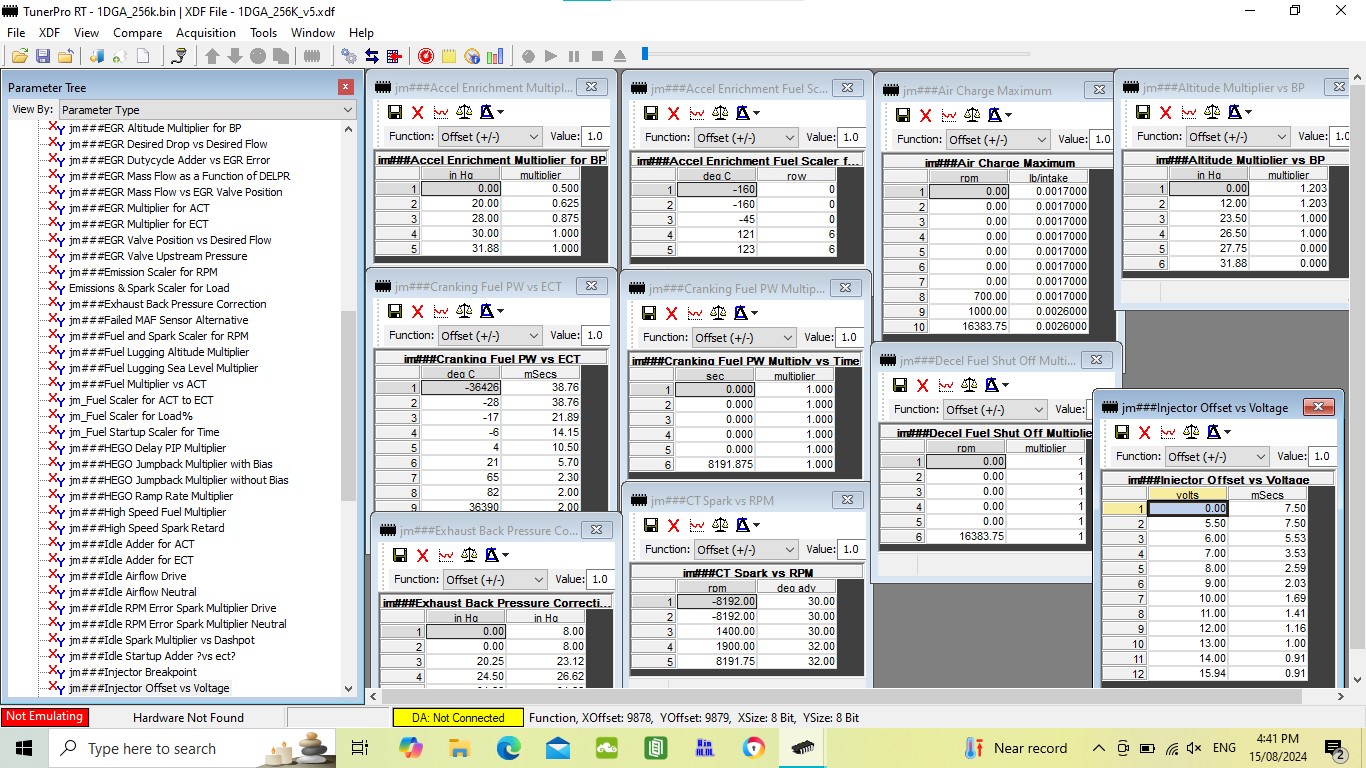

Have been working away at the Consolidated dir and the XDF.
The 1DGA XDF should be more usable now and only a couple things i wasn't sure about the addresses.
I added all the addresses to the ### error ones but haven't checked them out correctly yet.
1DGA_256K_v5_JM.xdf
(589.95 KiB) Downloaded 868 times
updated 27/08/2024 Jamie.
