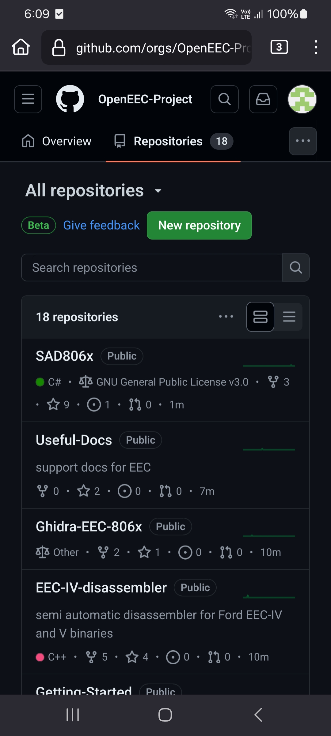

On github openeec.
Openeec was setup as a repository for the purpose of storing open info.
The various forums have proven to be temporary, with little regard shown to backing up data.

Ok. Is there a specific location to post "work in progress" DIR files, and am I able to do so?

You could start a new repository for each bin you wish to upload.
Motorhead is the owner of openeec, pm or email him if you are unable to open a new repository. He hasn't posted here in a while, let me know if he doesn't respond.
