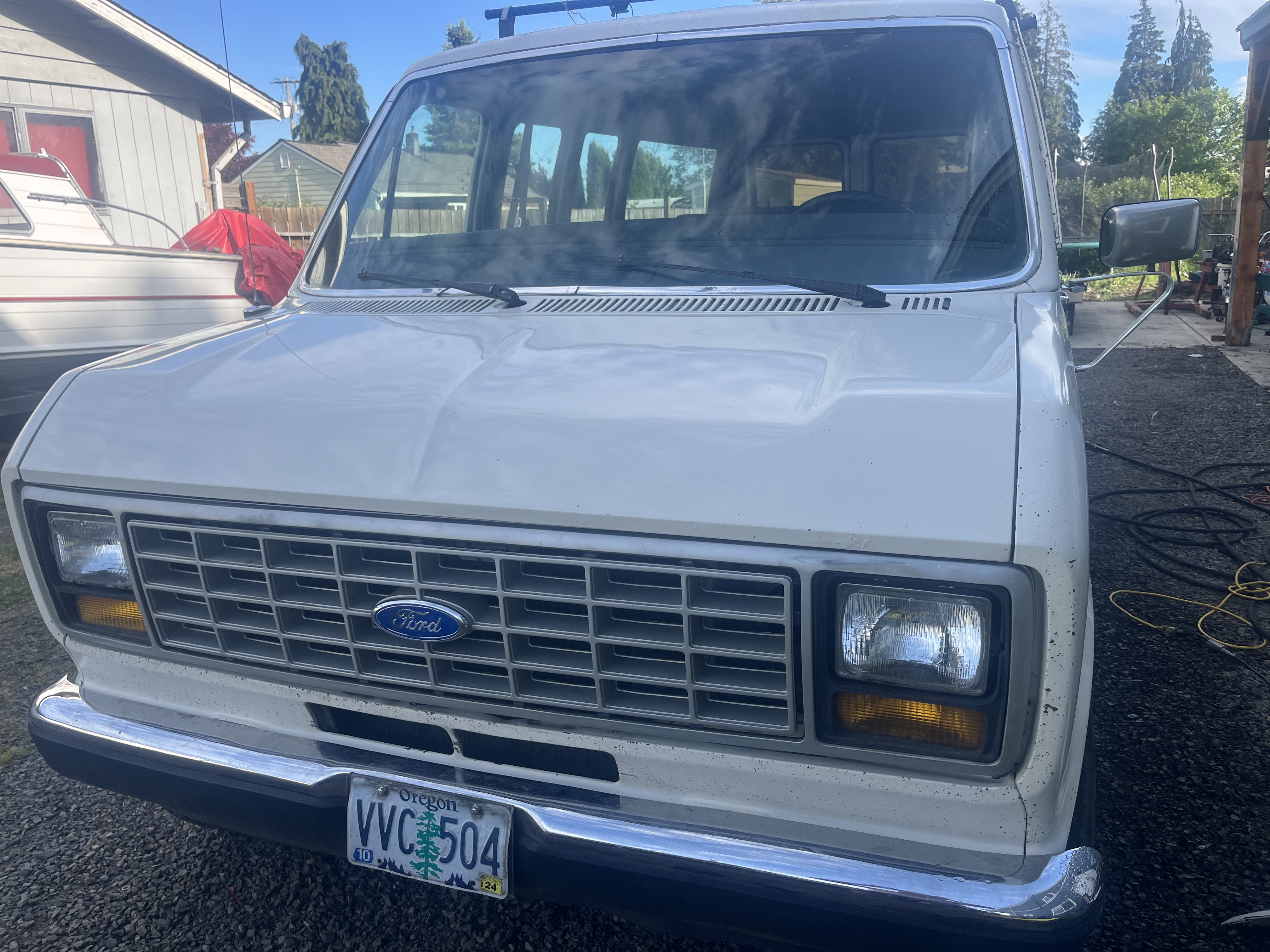

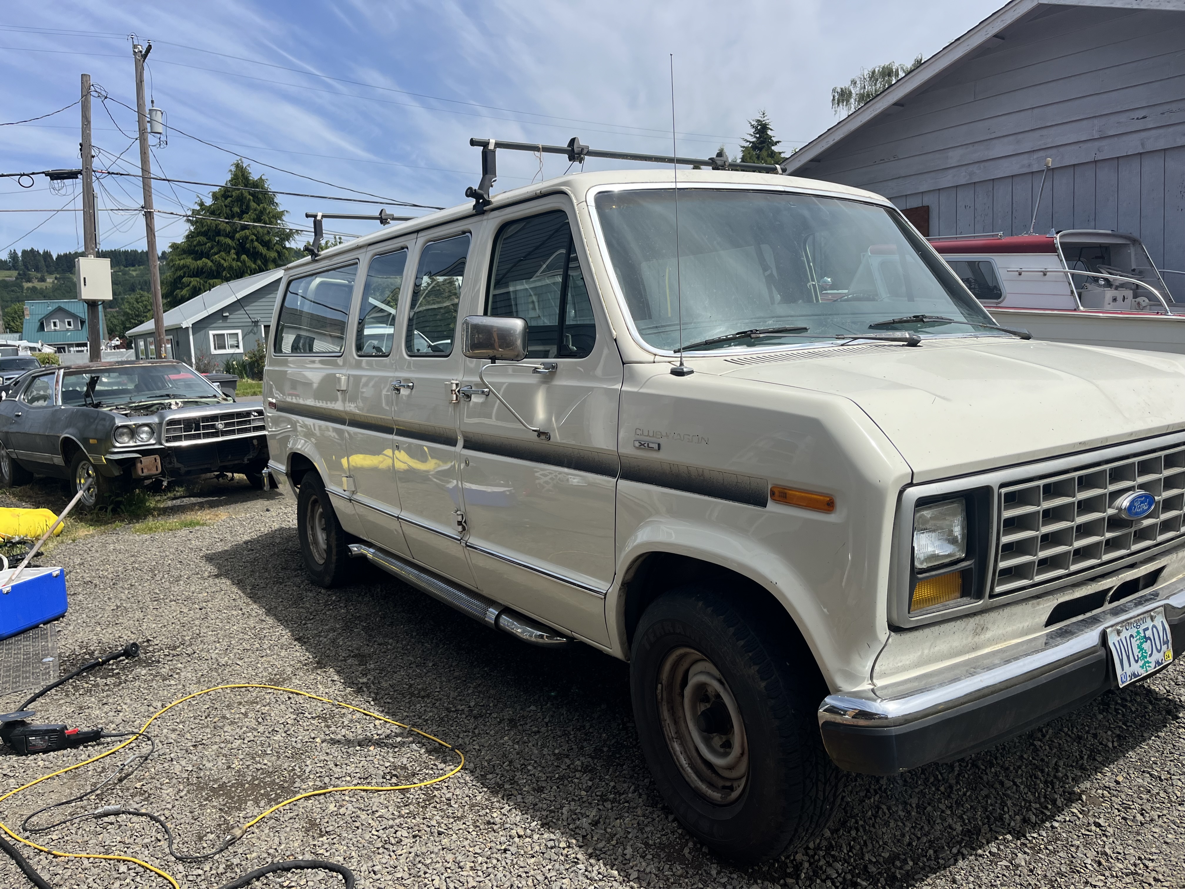

New guy here. I’m attempting to purchase aQH for my 1990 E-150 with a 4.9.
