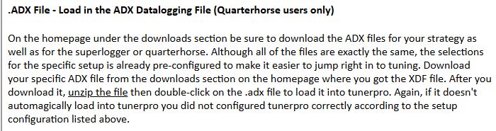

Now that I've switched over to TunerPro RT and beginning to configure it, I have gotten this far and now having a little trouble.
I'm not seeing where to upload ADX file?
Can anyone do me a screenshot of TunerPro RT with a little arrow or circle?

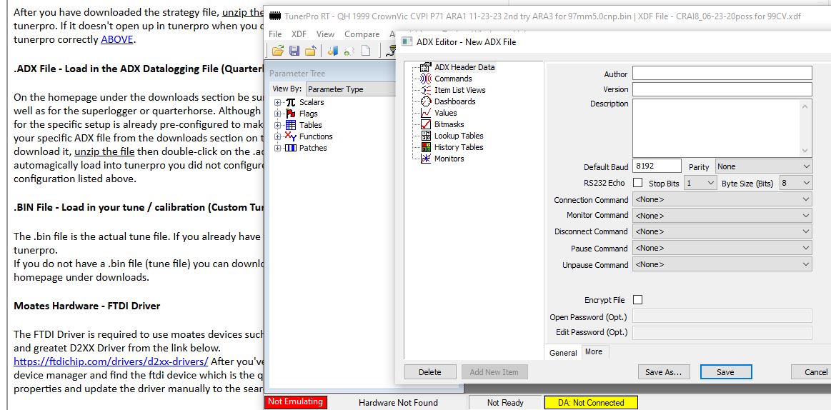

In my 2nd picture example, do I need to close that window within TunerPro RT and then double click the ADX file and it will automatically load into TunerPro RT?
As you can see by that pic, I haven't connected the Moates QuarterHorse device.

you can also click "Acquisition" at the top then select the first option to load the ADX file, then browse to where you put the .adx file

Correct, you should never have to be in that window for any reason.
You load the adx the same way you load the xdf or a bin file. You simply download the file and either double click it or open it and it will load in to tunerpro.

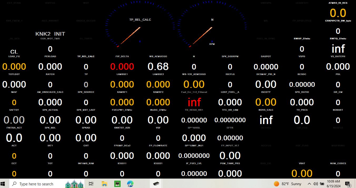

After contemplation as I was riding the mower, I decided to unconfuse myself and keep going forward from where I was at. This should probably be in the TunerPro category however TunerPro and the Moates QH are very related. I have learned my way around enough and have things configured such that I have the dashboard working.
