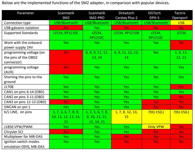

reading is no big deal anything will read them but writing requires the hardware to have an on-board 19v pull up so any device can read but only some can write

Scanmatik 2 Pro does write. I've done it two times. It does have the 19v pull up.
When I first purchased it and opened this users manual I said out loud "oh SH*T".
https://cdn.shopify.com/s/files/1/0556/ ... 1661901337
The Scanmatik 2 Pro still cost as much as the Drewtech Mongoose for Ford
