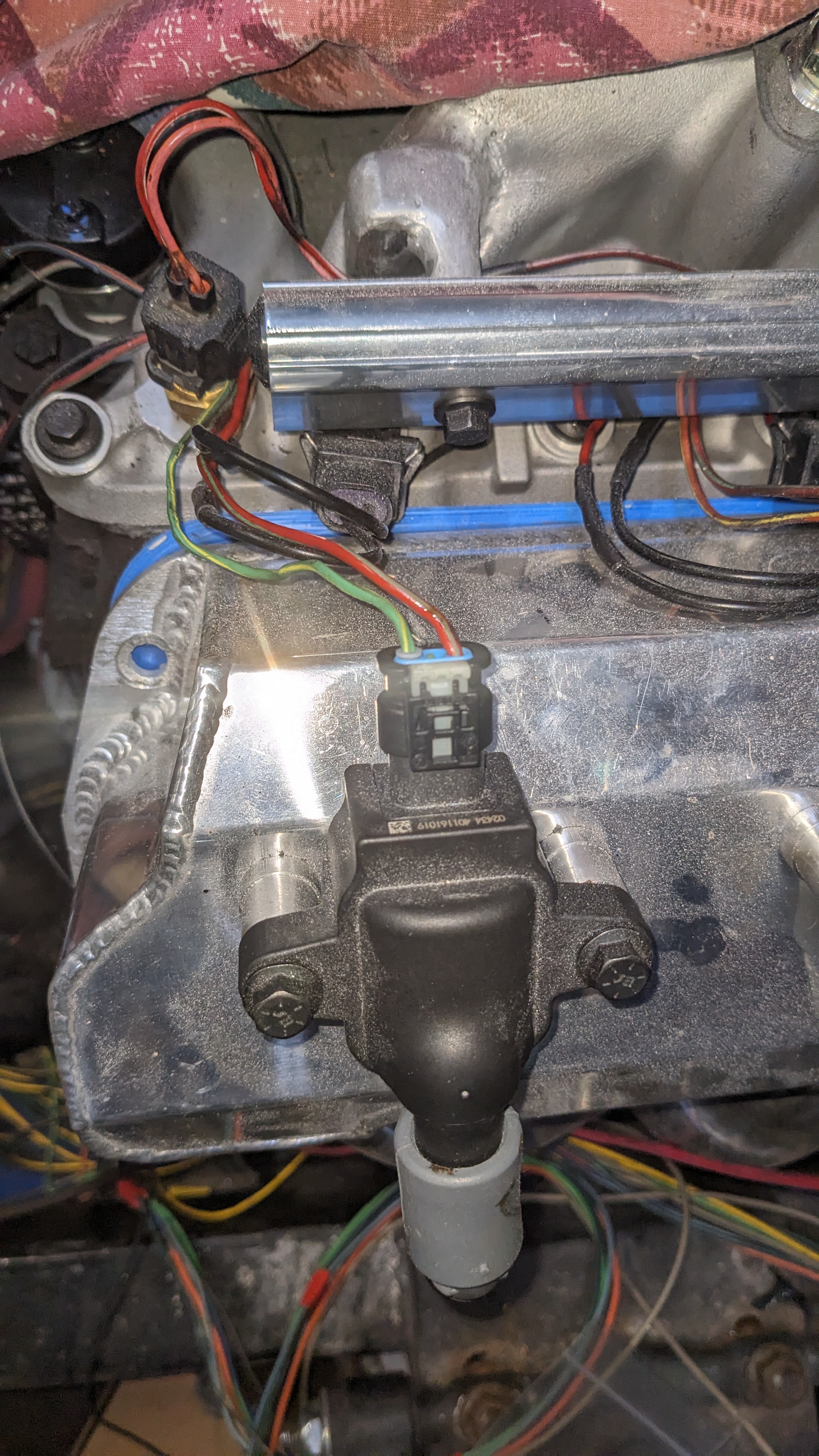

Being rained out from working outside on the truck, that gave me some inside time to study the wiring. I have had the 2 books having to do with this particular project open to the PCM 104 pin connector pages and have made a list of wires that will need swapped. There are ~ 30 to swap and in 3 instances, wires to be deleted. That may be enough to turn in to the 4 more coil wires that I will need. I have yet to remove the entire powertrain harness. Also I haven't forgot about the repurposed EGR wire to use for the wide band O2 sensor to use during RT tuning.
The '97 MM 5.0 harness will be used with the '99 crown Vic PCM. I know that there are better PCMs available. This first 5.0 project will be using these parts and the 2003 full size sedan PCM will be saved for the 2nd 5.0 c-n-p project.

I will have a few pins with short wires available, from the deletion of the rear O2 sensors, for the addition of 4 more coil drivers. The 1997 MM harness only has 4 for the wasted spark way of doing things. So far I haven't found any damaged wires as it relates to the coil power, trigger wires etc.
