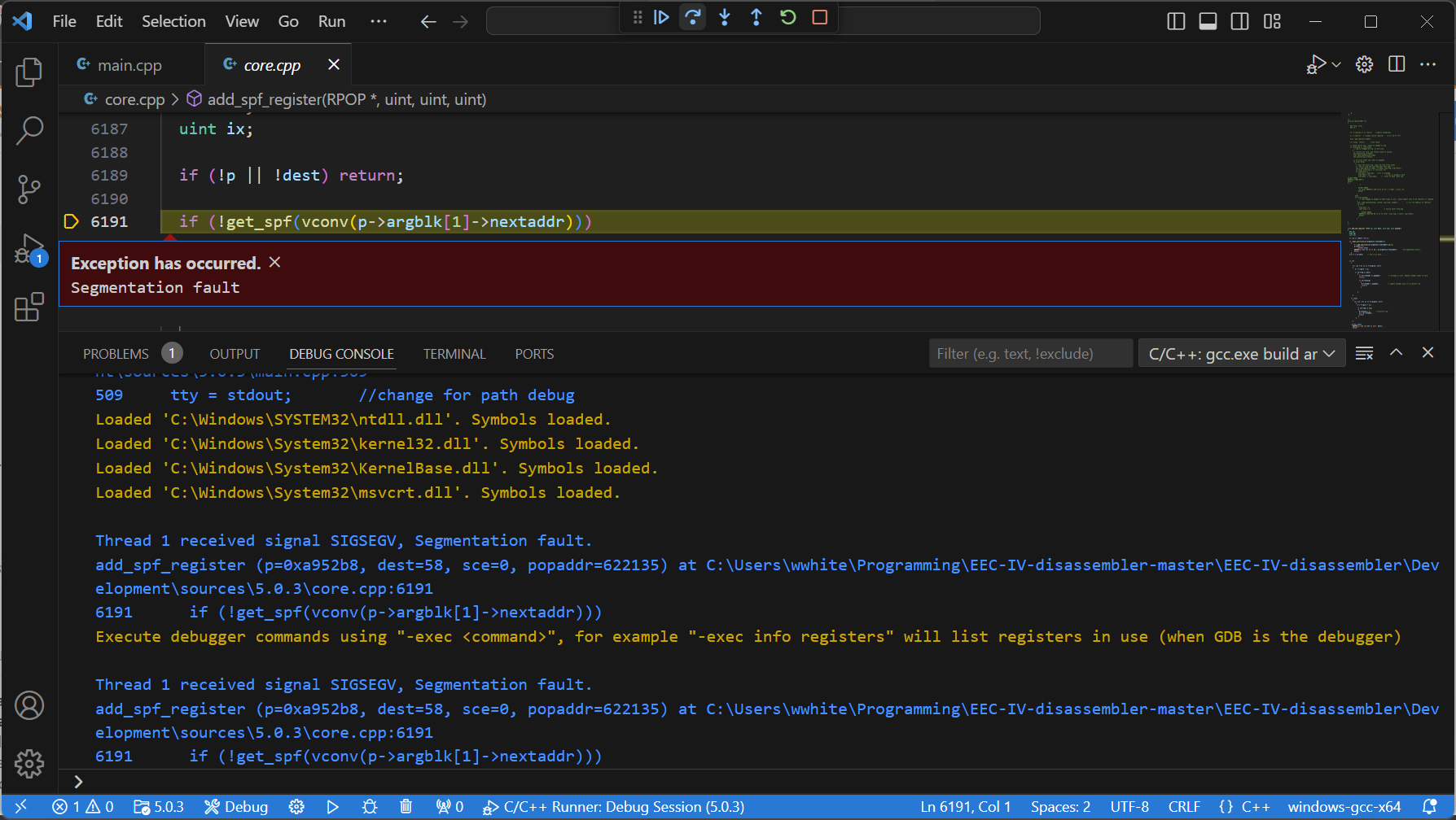

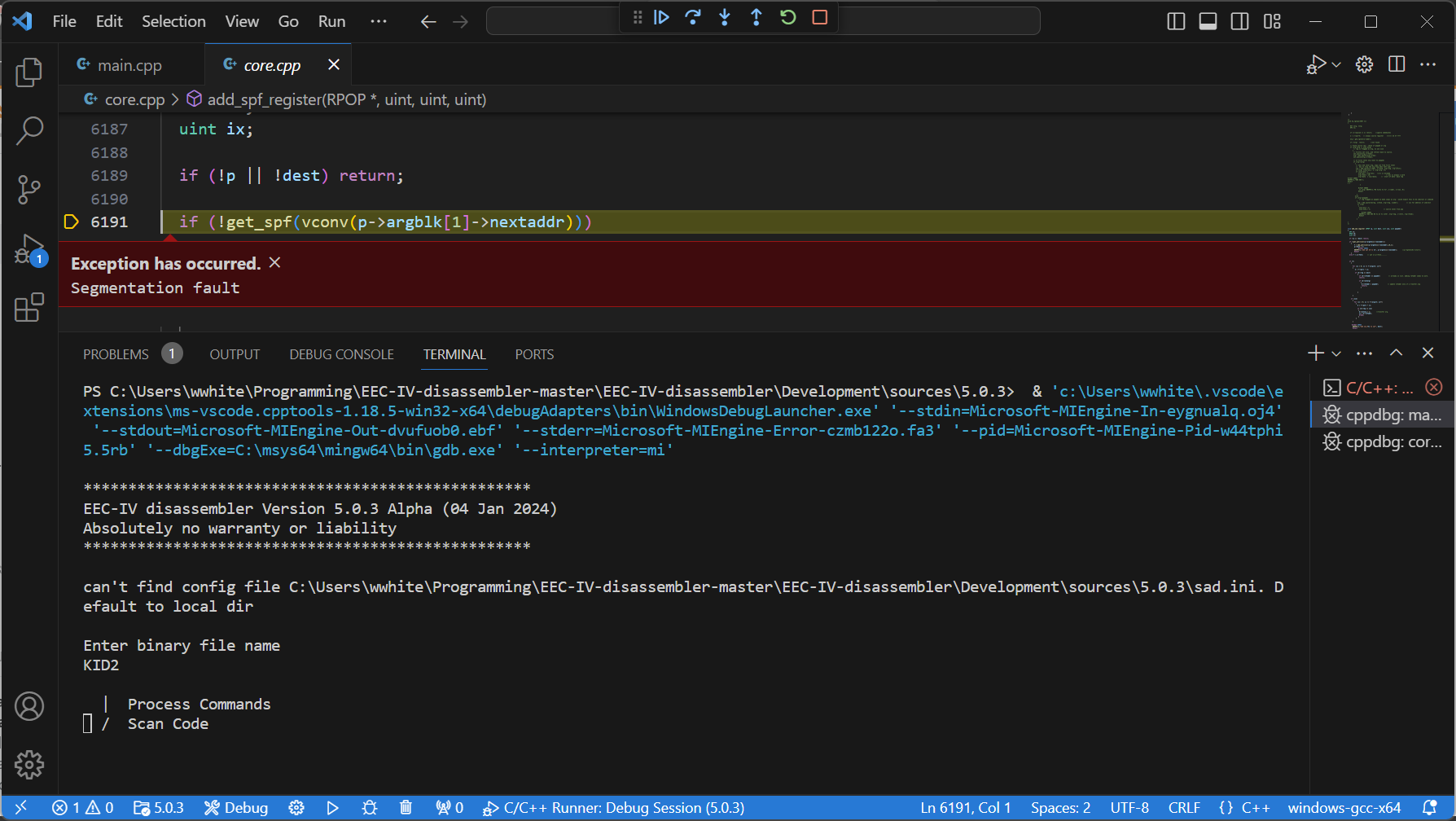

The program seg faults same location as pre 5.0.3.
Screen shots attached:

Re: SAD Version 5 (alpha)
Here is a full back trace:
Reading symbols from sad.exe...
Starting program: sources\5.0.3\sad.exe
[New Thread 11492.0x2bb8]
KID2
Thread 1 received signal SIGSEGV, Segmentation fault.
add_spf_register (p=0xaa6ba8, dest=58, sce=0, popaddr=622135)    at sources\5.0.3\core.cpp:6191
6191      if (!get_spf(vconv(p->argblk[1]->nextaddr)))
#0  add_spf_register (p=0xaa6ba8, dest=58, sce=0, popaddr=622135)    at sources\5.0.3\core.cpp:6191
#1  0x00007ff6df544f9c in ldx (s=0x9b3540, c=0x7ff6df573ca0 <einst>)    at sources\5.0.3\core.cpp:6508
#2  0x00007ff6df547b1a in do_code (s=0x9b3540, c=0x7ff6df573ca0 <einst>)    at sources\5.0.3\core.cpp:8093
#3  0x00007ff6df5427ed in scan_blk (s=0x9b3540, c=0x7ff6df573ca0 <einst>)    at sources\5.0.3\core.cpp:3681
#4  0x00007ff6df546d62 in scl (s=0x9b3270, c=0x7ff6df573ca0 <einst>)    at sources\5.0.3\core.cpp:7566
#5  0x00007ff6df547b1a in do_code (s=0x9b3270, c=0x7ff6df573ca0 <einst>)    at sources\5.0.3\core.cpp:8093
#6  0x00007ff6df5427ed in scan_blk (s=0x9b3270, c=0x7ff6df573ca0 <einst>)    at sources\5.0.3\core.cpp:3681
#7  0x00007ff6df5429c0 in emulate_blk (addr=623014, caller=0xab3b90)    at sources\5.0.3\core.cpp:3852
#8  0x00007ff6df546a78 in do_sub_scan (caller=0xab3b90, c=0x7ff6df573be0 <cinst>)    at sources\5.0.3\core.cpp:7421
#9  0x00007ff6df546ca5 in scl (s=0xab3b90, c=0x7ff6df573be0 <cinst>)    at sources\5.0.3\core.cpp:7526
#10 0x00007ff6df547b1a in do_code (s=0xab3b90, c=0x7ff6df573be0 <cinst>)    at sources\5.0.3\core.cpp:8093
#11 0x00007ff6df5427ed in scan_blk (s=0xab3b90, c=0x7ff6df573be0 <cinst>)    at sources\5.0.3\core.cpp:3681
#12 0x00007ff6df54819a in scan_all ()    at sources\5.0.3\core.cpp:8506
#13 0x00007ff6df54ad9f in disassemble (fstr=0xaa6510 "KID2")    at sources\5.0.3\core.cpp:10565
#14 0x00007ff6df54beee in main (argc=1, argv=0xaa3d30)    at sources\5.0.3\main.cpp:593

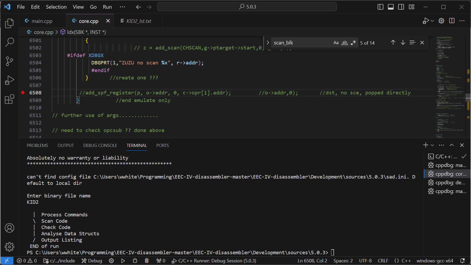

Posts: 413
Well, I commented out line# 6508 in core.cpp, and it works!!
I have no idea what the following does, but for single bank its good.
6508: //add_spf_register(p, o->addr, 0, c->opr[1].addr);
Posts: 413
Spoke too soon.
Works with no dir file, and with a dir file it seg faults still.
