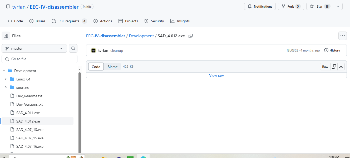

2 months ago, I successfully created an _lst file with SAD. Now when I do it, it looks like a bin file name. What am I doing wrong?
Copy this image that I captured and circle the spot where I need to drop and drag the bin file.
Also, when using SAD, should I start with a 256k 0-1-8-9 bin file?

After sleeping on it last night, I wonder if I'm actually putting the bin file in SAD correctly, but it is as simple as not labelling the new file correctly?

You need to download SAD to your computer, then drop the bin on the local copy of SAD.
That screenshot is on the website GITHUB.

OIC. I'm not supposed to go to GitHub to use it, just download it. Thank you for the pointer.
