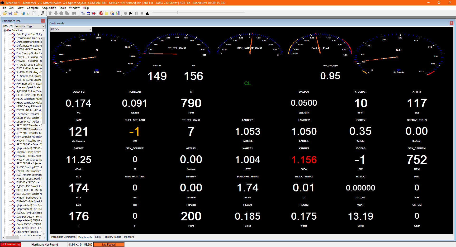

When the KAMRF2 goes out of wack, it goes super lean or what I think is perceived as a voltage drop to 0.000v? The value seems to always be 1.156 or 1.157. I don't see any blatant voltage drops elsewhere in the dashboards either. Also HEGO2 & Lambse 2 report normal when this happens so it's not a phantom HEGO2 source. Screen shot attached.

Regardless, I found the settings to define a single/mono O2 sensor in Decipha's A9L2 code under the NUMEGO functions as said in the Summary. Since only 1 O2 sensor is defined and my values are consistent, there is no need to chase down the mystery of where the weird signal is coming from unless the same weird shyte happens but thus far this is the only anomaly I've ever seen :)
