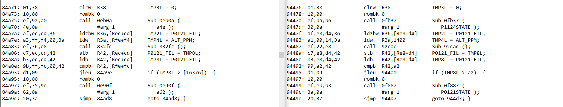

I have a quick question when looking for similarities. it is about the arg in the list file. The first example is from the eqe3 lst file second is the rzasa lst file that I think matches, but I am having problems defining it in the dir file. I first tried it at address 9a4, but obviously it is not correct because it does not define it in the lst file when i put that in the dir file. Please help me understand the arg code a little better? not sure what to do when there are 2 different arg in the same area. Thanks
83113: ef,cb,b4           call  0e5e1            Sub_0e5e1 (
83116: a4,09                    #arg 1              9a4,
83118: 05                       #arg 2              5 );
83119: 91,40,89           orb   R89,40           EGR_MON = 1;
84213: ef,71,b6           call  0f887            Sub_0f887 (
84216: 8a,0a                    #arg 1              P0400STATE );
84218: 91,40,88           orb   R88,40           EGR_MON = 1;

here is a couple more examples of the arg in code.
